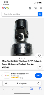

If they are 3/4” head, get a shallow 3/8” drive swivel (universal) socket. Might have to cut the extra length of the stud since it’s a shallow socket. I use an old v series craftsman, and i think there are shallow mac sockets that work as well.

If those are 3/8" anchors you should be able to get 3/8" nuts with reduced wrench size heads. They are available for most thread sizes.
9/16” socket will fit inside strut all day. 3/4”, not so much.
