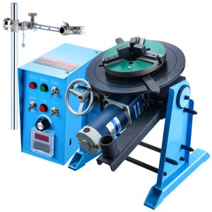

Bought this Vevor rotary positioner about a year ago and it remains in the shop as used often. For the money works well. I had to build some jaw extensions as I often do aluminum tanks and filter housings.
