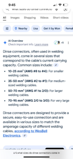

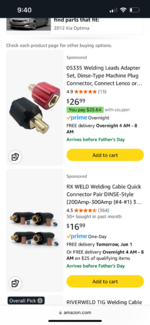

If your cables are in good condition replace the connectors. Have you seen the price of new cables lately? Dinse connectors come in two common sizes. I believe the 10-25 is 25 mm dinse style connector, and the 50 is 50mm connector. This is a good reference for size.
