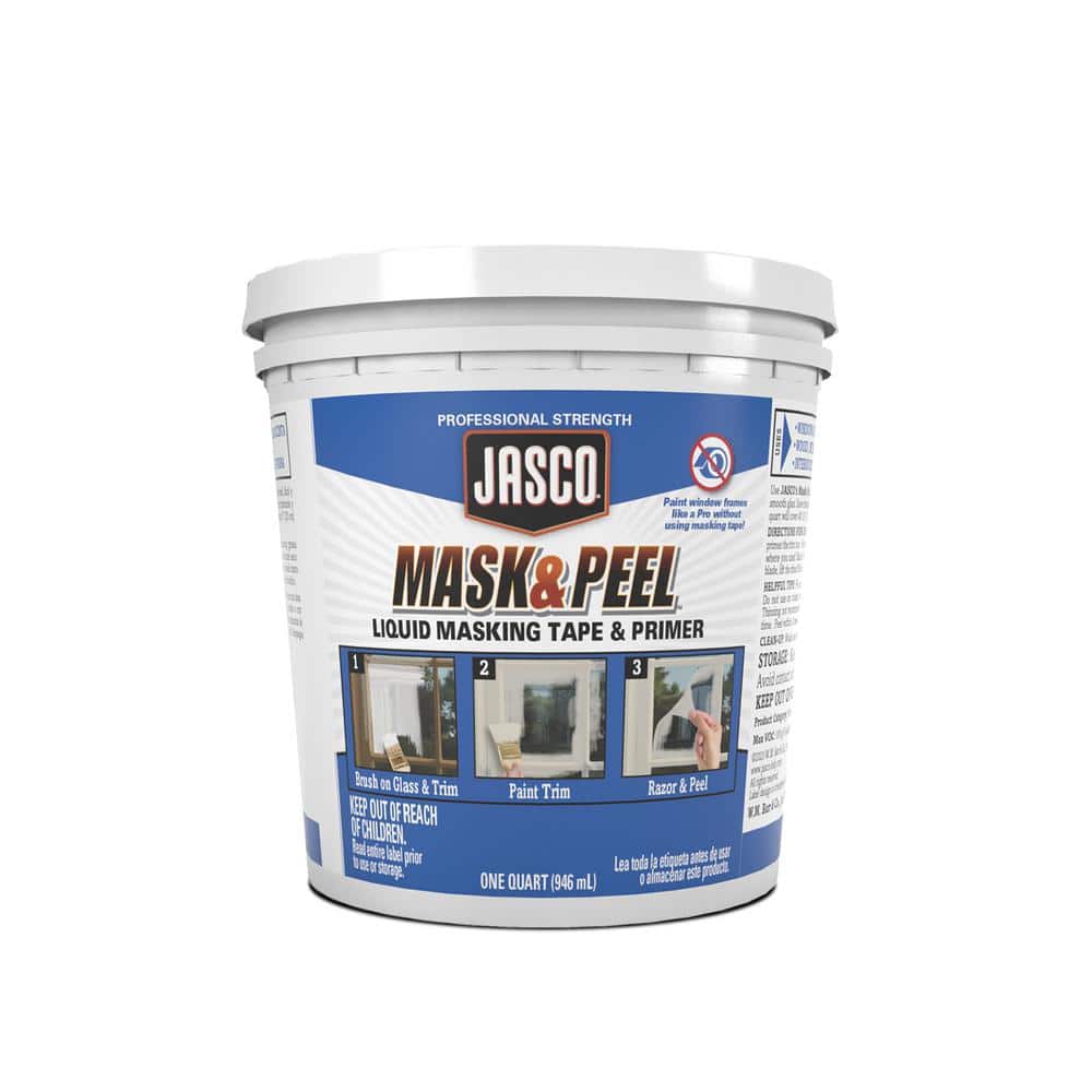

Never used it, but if it’s sold on amazon it must be good.

Why not just buy liquid masking tape which is made for this?
Alternatively, you could paint the main part of the cover first, then mask around the lettering and paint the lettering second.
I looked at that stuff. To make it work, I'd have to spray it on, and trim each letter with the X-acto knife, which is just as tedious as using masking tape.
They actually make a brush-on type for small parts, but again seems very tedious. Maybe I'm just a lazy *******?...LOL.
They actually make a bus-on type for small parts, but again seems very tedious. Maybe I'm just a lazy *******?...LOL.
How is brushing this stuff on any more difficult than brushing plasti-dip on?
