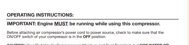

Check the voltage at the battery and at the compressor or at the closest connector. Low voltage will result in higher current draw. If one of your connectors has a high resistance it might be causing the problem.
BrandonV
Jun 9, 2023
4,030
Arizona
This. It's why they want the vehicle running.

These are the performance specs for the compressor. At 30 psi the chart states that it pulls 18a's. I'm also using 25' of hose as compared to the original 16', if that makes any significant difference (?).
Battery voltage is 13.75v and at the connector it read. 13.74v, so the battery to connector run seems to be good.
