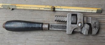

There seems to be no specific thread for Stillsons, but here's a 6" I picked up yesterday at a "Harvest Festival" junk sale. It seems too small to be of much practical use, which is perhaps why it shows little wear.
My grandfather and uncle ran a plumbing shop, and every pipe wrench was a "Stillson" no matter who made it. I don't know if this was common elsewhere (the shop was in Brunswick, Maine).

ganymede
Nov 29, 2012
2,332
New England
Walworth was right here in Mass.
I think the factory was in Cambridge and offices in Boston.
Stillson worked for Walworth when he invented the wrench.
In my years collecting Ive seen as many marked Stillson type wrenches as un marked regardless of brand.
Anyway, nice wrench and that's a beautiful ruler too.

On the utility of the 6" wrench...
The first WWII Motor Vehicle Mechanics Tool-Set, a carryover from a prewar 1938 manual, had a 10" pipe wrench. In 1942 they must've thought that insufficient for all jobs, as the updated manual specified a 6" and a 14", heavy duty.* One of the most common brands collected is Walworth WALCO. Another is Trimont TRIMO. But the most common is Ridge RIDGID, which is not a Stillson pattern wrench.
* in addition to metallurgical composition, the Army distinguished heavy duty from normal duty by a removabe jaw insert, which was more efficient to replace than the whole wrench if the fixed jaw cracked. Pipe wrenches without this feature are normal duty.

I was under the impression that a Stillson pivoted on a pin while a heavy-duty pipe wrench pivoted on the adjusting nut. Or is that oversimplified?

Alan,
I admire your 'preservation' approach to that wall.
The difference between a Stillson pattern pipe wrench and the initial Ridge patent (1,552,091, 1925) and all the Ridge licensed or unlicensed knock-offs has to do with the adjusting nut being behind the housing and various mechanism improvements internal to the housing.
Both Stillson pattern pipe wrench makers (e.g., Walworth, Trimont, etc) and RIDGID pattern pipe wrench makers (e.g., RIDGID, Erie, etc) made pipe wrenches classified as normal duty and heavy duty according to federal specifications from the 1930's through the 1950's. I don't know anything about commercial/industrial specifications, but I would assume they followed suit. The federal government has always been the largest customer.
The only noticeable difference between a normal duty and a heavy duty pipe wrench (again, the other differences being metallurgy and heat treatment in forging) is the removable jaw insert. Vintage pipe wrenches that have them are heavy duty. Vintage pipe wrenches that do not are normal duty.

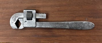

Here is a Walco Hex Wrench No. 0. The 8” wrench has the Stillson’s patent adjustment, but with hex jaws. The trademark is a “WALCO HEX” framed in a hex which is framed in a horizontal diamond. I haven’t seen this logo before. On the back, it is stamped “PAT APPLIED FOR” twice (see photos). I haven’t tracked down the actual patent. This one was in bad shape as it took maybe 72 hours of soaking in various solvents before I could get it back in working condition.
