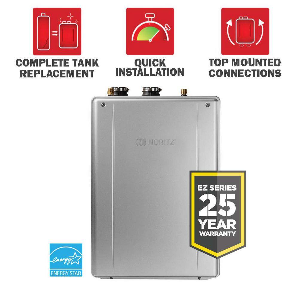

  • Tankless water heaters in my area have a $800 to $1000 rebate from the Gas Company
  • There is also another $300 in Federal Tax credits
  • Waiting for hot water can easily be solved with a recirc pump. The more expensive models have them built it or you can use a traditional recirc pump. If you don't have a 'dedicated' recirc loop, the easy fix is to install a 'bridge' to connect the hot and cold water lines at your furthest sink
  • Depending on your location, a tankless can provide up to 11 gpm
  • Maintenance is usually a yearly flush. You connect a couple of hoses up to pump in a 5 gallon bucket and run a solution through the heat exchanger to descale it
  • Some tankless water heaters have a 25 year warranty on the heat exchanger
  • Why heat a tank of water up 24/7 versus on demand
This Noritz comes with the 25 year warranty, the water connections are on the top for an easier install, and it is sold as a kit - which includes 25' of vent and everything you should need. After rebates, should be around $1000. Why wrestle around with a 200lb water heater and reclaim some space in your garage/where your water heater is now.
I have been on the fence on what to buy, but at this point, I am pretty sure I am going to go with this Noritz or a Rinnai
Go Rinnai.
Awesome units.
All the BS about taking forever to heat is just that BS.
Installed our 5 months ago. Best thing ever
