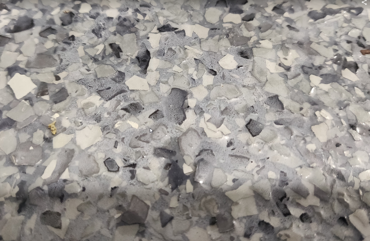

I've gotten some water on my epoxy floors by the entry doors. I didn't wipe it up and it dried naturally. Now the epoxy coating is cloudy / dull where it the water dried naturally.
Is this a defect in the product, how would I fix?
Floor was installed in September 2019 and didn't have any issues then. Just now.

Better pics would be great. My guess is that the floor was not fully sealed and the moisture found a void. The cloudiness is the moisture trapped under the seal-coat.
A very close up pic would clear it up, no pun.
If this is the case...hit it with a hair dryer or drill a tiny, tiny hole in the middle of the stain.

What happens if you try to wipe it off with a wet rag and then let it dry again ??? Could just be minerals in the water that are left over when it dries ?

I tried a hair dryer / heat gun and heat doesn't give back the original gloss. It definitely looks the dullness is on the surface.

Wipe it with a bit of acetone or xylene on a q-tip. See what happens. Any buildup from the water should wipe off.
then , if that doesn’t work, see if you can sand through the dullness. Try a green scuff pad or similar.

I tried acetone. It doesn't do anything.
I'm able to scratch the dullness out with my finger nail. But it takes a long time and alot of pressure.
It's happening over the entire floor once exposed to water. Which seems like an issue withe product? I was thinking of just hosing down the entire garage (haven't done since new) and just letting the entire floor dull out, but would like to know what's causing the issue in the first place.

Odd, even for an epoxy topcoat.
Get on the phone with the mfg on Monday.
Did they give you a choice on topcoats? Most installers reserve epoxy topcoats for basements and spaces not subject to vehicle traffic.

It's an UV stabilized EPOXY top-coat they put on. It's not yellowing just dulling. I might just have to flood the entire floor with water just to get a uniform look now.

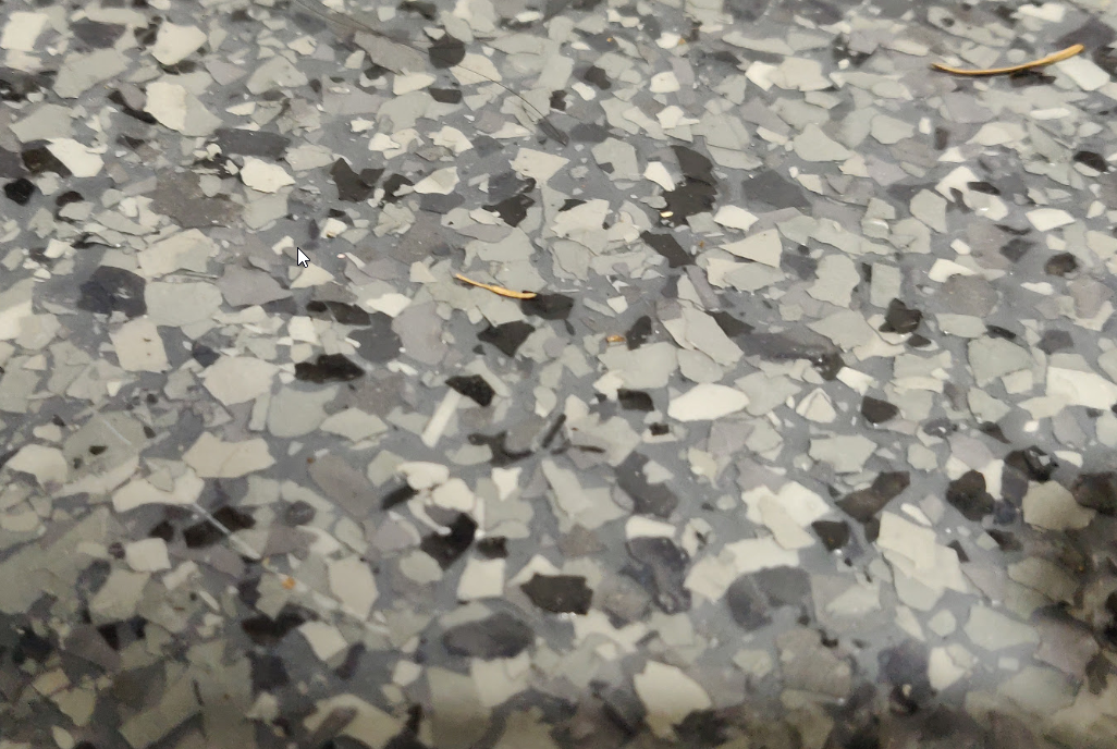

WKDiesel,
How did you end up sorting this? I am having the exact same issue all over my epoxy floor (which runs through my entire apartment). If I water my plants and get some drips on the floor, leave a mop bucket on the floor, etc anything with water it leaves these exact same cloudy marks!

I actually used brake cleaner on a rag and it seems to clear it up a little. My entire floor ended dulling so it's not as noticable anymore. My experience with epoxy floor was not as good as I thought it would be. I think I'll just be going to a polished floor with a acrylic sealent in the future.

I had same issue. Cleaned with glass cleaner (ammonia based) and rubbed hard with towel and stains went away. I’m sure when a little rain water get in again it will stain but thus far it’s worked.

I'm probably off base since I have a hard time seeing the detail in the photos, but- could it be minerals from the water? Hard water, iron piping in the building? something acidic like CLR would take up the deposits if that was the case.

The problem here is that they used an epoxy as a topcoat, epoxy is not a topcoat and inherently is not chemical or stain resistant. Urethanes, Polyaspartic, Balistix, etc are topcoats.
