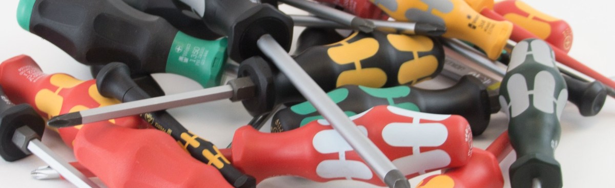

I have some of these screwdrivers I bought NOS several years ago. Most are still brand new.
These are all made in Germany.
Any idea how old they are? I'm thinking somewhere in the 90's but can't seem to find much information on them. 20250124_003845~3.jpg20250124_004026.jpg20250124_004042_HDR.jpg20250124_004103.jpg20250124_004131.jpg

No idea on the age of these. But Wera is very talkative, if you e-mail them with those pictures, they will most certainly tell you more about them. (That is, if no one on GJ can chime in on these.)
All I can add is an eBay link: https://www.ebay.de/itm/194919358075
They have a lot of ”vintage” Wera, Wiha, (…) screwdrivers in their shop: https://www.ebay.de/str/cmcuttingtools

I'm not a Wera expert but I'd guess they're quite old (stupid answer, I know :) ). The bicolor black and green Kraftform were introduced quite some time ago, IIRC over 20 years, 2 molded digits at the bottom of the handle encode the manufacturing year, probaly also valid for any color combination as the tooling is the same.
Never seen the pictured grips, during many decades you nearly only saw PB here and maybe some screwdrivers with wooden handle (don't have any single one of them).
As I don't have old Wera print catalogs I can't check it. My uneducated guess would be mid to late 90's but I can be wrong.
Personally I'm not a fan of "ergonomical" screwdriver grips, too bulky. If I need more torque I use ratchets as well as T-grips with scfrewdriver sockets forged as single piece rather than bits, or screwdrivers with a hexagonal of square belos the handle, or a adjustable wrench at the bottom for slotted screws.
I tried lots of various exotic grips in stores and liked none of them. I don't even like the newer PB grips forms nor the Stahlwille DRALL, DRALLl+ nor the 3K DRALL which easily gets dirty.

It’s quite a while since those were made.
I can recall a shop opening in I think the mid to late 90’s that was stocked with the green ones.
On that basis I’d probably say early 90’s, or earlier!

Those were made in Germany.
They shifted production to Czech Republic in 1995.
The Kraftform handle design was developed in 1968.
Some of the old Wera tools had W. Germany markings.
Lacking that, I would guess these after the fall of the wall in late 1989. That would place them 1990-95.
I have a few of these same hard handles and I prefer them over the bi-material grips.

The red ones shown correspond to the modern form with a flat at the botton, as said, one has the manufacturing year coded as two digits, engraved in the injection mold (for example 05 for 2005).
The stainless steel versions are only useful for stainless steel to avoid the transfer of rust particles but are otherwise less robust than the regular cheaper usual versions. No idea if the laser-processed (rougher surface) tips make a huge difference, never used any.

I have a red Wera/Germany bit driver with a handle like those (it holds ~6 bits in the handle); it's from 1993. IIRC it came from McMaster Carr.

I never saw any of those old red handles. Either in the catalog or online there are or were some explanations about the development of the various Wera grips.
The screwdrivers at the bottom of the pic are typically used by electricians for screw terminals. I'd very highly recommend to get some as the insulation of terminals easily ends damaged if using DIN/ISO screwdrivers, also for set screws.
The ones above are the most common ones (i.e. DIN/ISO). There more convenient Swiss VSM are rarely posted.
That makes sense. I just wasn't sure when manufacturing moved away from Germany. And if some tools were still made there.
I've had these red handles for atleast 10 years. The black handles came from the same closeout supplier. Probably mid to late 90's. Also had the solid yellow striking screwdrivers.
I have a set of the newer Wera in the green/black, yellow/black color schemes.
Here is my stash of new screwdrivers.
