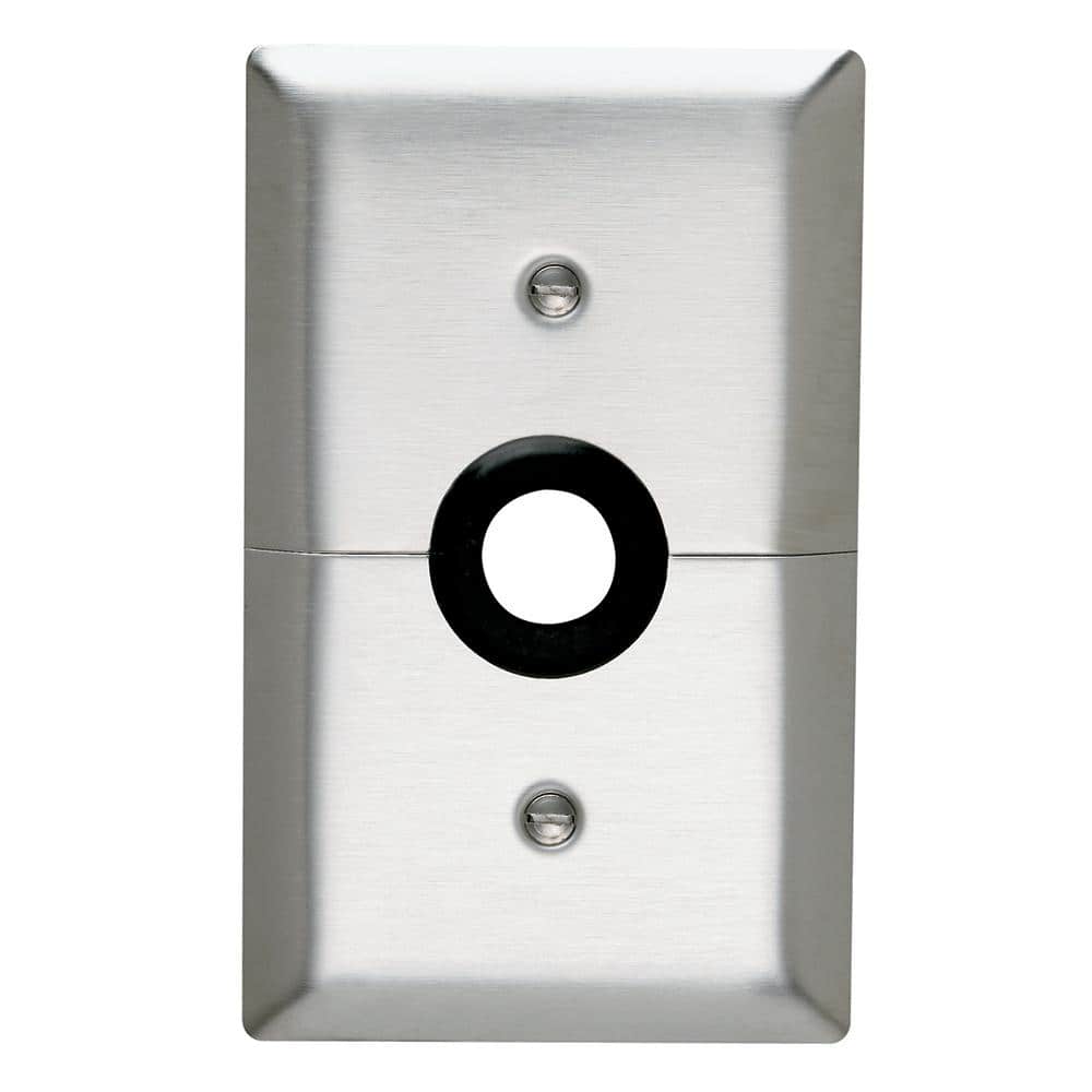

Search switch plate adaptor. It will provide for standard cover plate screw pattern to fit to an electric box tabs.

Like one of these.
