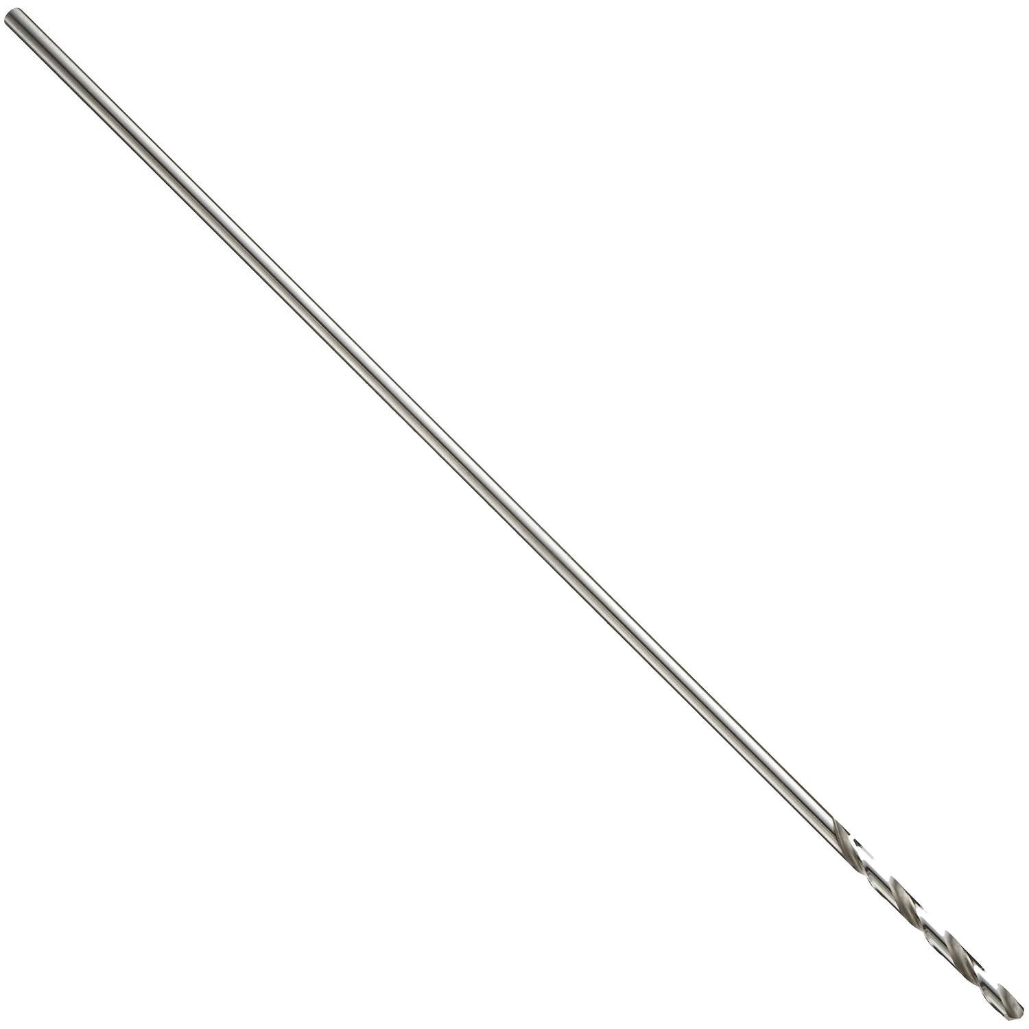

You also have long length, and short, or mechanic's/machinist's length bits. Another bit type is Aircraft, which gives you the length of Jobbers, but with only the tip ground to a spiral. This allows you to have rigidity but still have reach, but with a reduced drilling depth, which is perfect for work in aircraft fastening structural members to the skin, etc.

There is an even shorter one called "screw machine" and a long air craft version that might be up to 12" or more in length and maybe only 1/4" diameter.

The aircraft drills are often similar to jobber's length, but they only have spiral near the very end, the rest is just unground shank, as mentioned above they are used for aircraft because you usually have to get into tight spots, but are normally drilling through thin structural members and sheet metal, so you don't need very much spiral to exhaust the chips.
