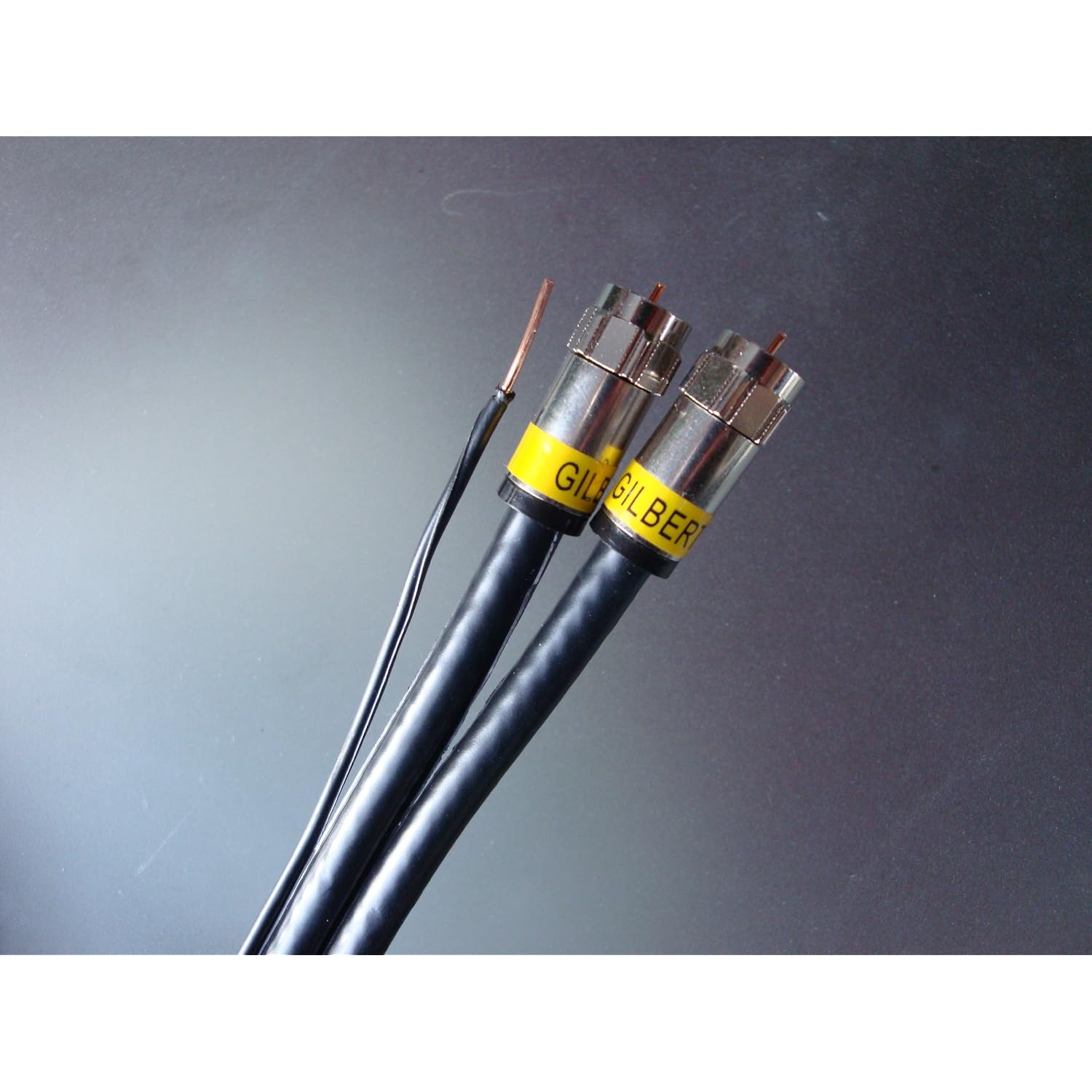

This is RG6 with attached ground:
This is RG6 with messenger:
Having to hold the cable up, the messenger is larger. To me, that picture looks like a ground. Given grounding requirements, cable companies around here use the same cable for both the aerial and the drop to the grounding block, usually with RG6 with attached ground at least to hit the grounding block on the house, and often inside to the splitter.
YES, that IS a ground. That is indoor cable with an attached ground.
That is also NOT the cable in question.
This IS the cable in question and that extra wire is a MESSENGER, NOT a ground.
It even gives the messenger's strength rating since it's job is to hold up the cable in an overhead span installation.
Where in this second image does it say that the messenger is also a ground??

Well, this electrician DOES do low-voltage.
You've missed the point I think, and no, that is outdoor cable... NEC 810 requires it for only the outdoor portion of a satellite dish installation. There is no need to use it indoors.
Cable companies are installing the same, and using the ground/messenger as both the messenger and connecting it to the ground block. Most recent satellite installations use the same cable with dual RG6's and the single attached ground, due to multiple LNBs/etc. That is not indoor cable, it was designed specifically for grounding since it goes up to the satellite dish on the roof.
The NEC doesn't really get involved with low voltage, except in this case (there may be others) as it can affect the entire electrical system. So the NEC actually defines how this "lead-in" wire from the antenna, pole or a roof-mounted satellite dish are grounded.
With cable, unlike satellite or antenna, a separate ground is not required on the aerial/etc. and the sheath can be used... however that can introduce its own problems. (It's grounded at the grounding block anyway no matter what is chosen) So many cable companies are just using it for both.
I never said it did. I just said I believe based on the size that the cable attached is sized for a ground, and not just a messenger. BUT... in the second image it does say perfect for satellite and master antenna, which would require it to be the ground.
