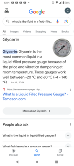

I have an air compressor that has a fluid filled pressure gauge. While doing some repair, I lost some of the fluid. There is a fill plug on the top, so if I knew what the fluid was I could refill it. Could it be something like mineral oil? Obviously its clear but doesn't flow as fast as water, it doesn't have much of a smell.
I appreciate all comments.

It's glycerine, you can buy a bottle of it at any drug store. It's not required for the gauge to function though, it's purpose is for vibration dampening for the needle etc, like to able read it more accurately when the compressor is running & for gauge longevity. Mine came empty so I filled it, only reason I have the oil filled gauge is cause I got it for cheap on ebay.
Oil filled gauges should not be filled all the way to the top. Even then you should purge the air/vacuum seasonly. I never did this to mine, one day noticed the gauge was not reading correctly & thought it was bad. Purged it (mine has a manual vent but some have a ****** that can be cut to permanently vent) & the gauge started reading fine again.
