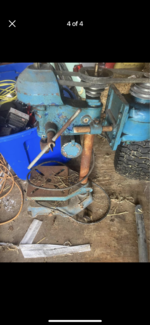

What is this cylindrical thing attached to this drill press behind the chuck? Maybe a drip setup for coolant?
C
creativename
Sep 20, 2019
4
PA
My wild guess would be it's a homemade shield for a light bulb, but I really don't know. Perhaps a photo of the bottom side would help.
I think this is it! Makes perfect sense. This is just a photo from Craigslist. Thanks!

Could be a nice drill, especially with the slow speed set-up as noted by RTM. Table actually looks to be in nice shape with no drill holes that I can see. A true barn find.

With the three pulley setup for slow speed, it’s worth buying to find out.
Does anyone recognize the center pulley mount? Is it factory or DIY? How does it work? Does the top plate swing from the end of the stationary bottom plate?
Provincial
Sep 21, 2011
6,883
Near Salem, OR
From the photo, it appears that the center pulley hinge has two parts. The bottom part sticks into the hollow column, and has a flat bar sticking out away from the camera, and there is a hinge joint on the far end. The top part hinges with the bottom part, and has a shaft supporting the center pulley. It wouldn't take much distance from the hinge joint to the centerline of the pulley to give enough travel to adjust the belt tension.
It is a simple and elegant design, limited only by the need for the hinge to be offset from the centerline of the pulleys. Without the need for belt guards, it works quite well, but if guards are needed, they would have to have a cutout or clearance to avoid interfering with the hinge.
