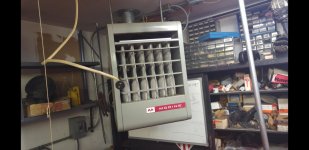

Over night 50° and turn it up to 70° when I'm in there. In the summer I open the door cause I have no A/C.
