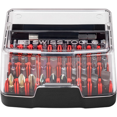

Late to the party here, but @KnurledNut has it right – that is just a poor quality outdated photo and a (recently) discontinued SKU.
The BitBox design was updated to a clear top – I believe somewhere around 2018/2019 before DRPD's time so I'm not positive.
The size markings on bits have been through a few iterations – first engraved, then laser engraved (like in the OP's photo) and then they went through a few different versions of the laser markings into what we now see today. The laser engraving kinda sucked as it left burn marks on the bits, but the current marking style is super nice – large and clear.

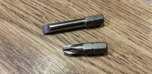

Thought I’d add my few cents worth to this.
When I first started buying PB Swiss (or PB Baumann as they were) bits, they were all plain steel bits. So if you see one, it might not be fake, simply old!
These are original bits from the 1990’s. Although some wear can be seen, it’s barely noticeable.
Sometime later (early 2000’s if memory serves) PB switched to TiN coated bits, with coloured bands.
The colour of the TiN coating denoted the type of bit, and the coloured band the size.
These were not a total success. The TiN coating was lovely, but they couldn’t consistently paint the coloured bands, and you only need colour coding to see the type of bit quickly - you can see the sizes.
PB then ditched the coloured bands, leaving us with the bits we have today. The black (well, more brown) bits are simply the colour coding for regular / slotted bits.
Very good bits. Probably the best. The coating prevents corrosion and also reduces wear. Nothing much I would change about these now.

I have that exact older style black bit box and I prefer it to the newer clear ones. For sure not a fake. It was more of a flexible plastic material and had a bit rounder corners. The bits in the picture do have the correct color, they are just older and the photo has poor lighting. It's hard purchasing PB bits if you want them to look identical because some have the round colored paint and some don't. The newer ones are marked so much better as the older ones from just a couple years ago had very small size markings which were more difficult to read.
