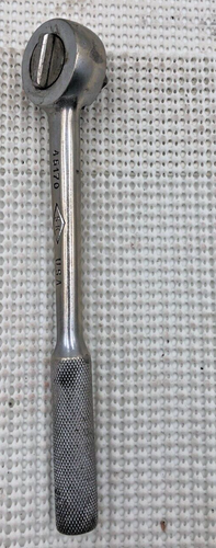

Hello everyone!
Thank you for stopping by to help a newbie.
I just picked up this SK 3/8” (45170) ratchet but I can’t seem to find any information about when it was made.
The SK logo is in between the model number and USA, I don’t see very many of these on eBay or other sites.
If anyone is able and willing to shed some light I would really appreciate it!

Welcome to the Garage Journal. Your ratchet is an interesting case and seems to be much less common than the diamond logo 3/8” Drive versions with the patent number on the same side as the part number. Obviously, the ratchet was made after the patent date which was granted in 1941.
The 45470 ratchets with a diamond logo and the patent on the opposite side could conceivably have been made during the short period of time between when S-K was sold to Wayne in 1962 and when Wayne began marking their tools S-K Wayne in 1964. Admittedly, that is a guess on my part but there is a certain amount of logic to it. There is a long span of years between 1941 and 1962 for the ratchets to have been stamped conventionally.

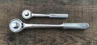

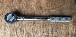

Unusually stamped ratchet with the patent number stamped on the opposite side. IMG_6718.jpegIMG_6717.jpeg

Thanks for the information! Would be cool to find a twin for this one :)

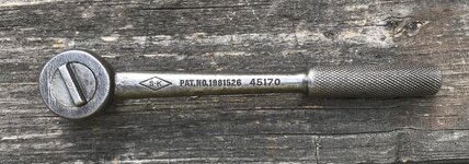

I don’t believe that they started marking the newer patent number on the 3/8” drive ratchets until after the end of WW2 when the metal restrictions were lifted. All of my wartime finish ratchets have the earlier patent number 1981526 stamped. IMG_8428.jpeg
