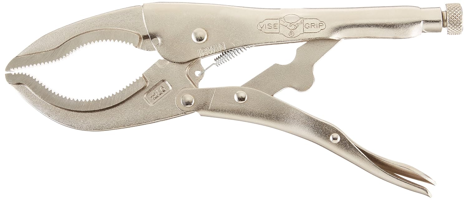

I use a vise grips
If that doesn't get it I use a 10 inch punch and hammer and drive it through the filter. I usually get punch a hole in the filter before removing any ways to get the oil to drain.
