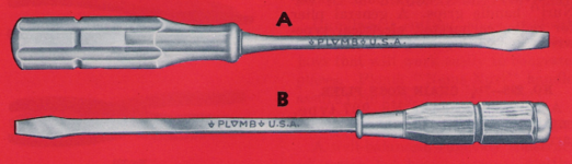

The handle looks like Plomb/Proto with the metal cap but with plastic handle.
Credit where credit is due, they're very attractive screwdrivers, and whoever did it had a brilliant idea, out-Plombing Plomb, so to speak.
The evolution of Plomb wood-handled screwdrivers to moulded composite (pyroxylin) from the late 1930's to the mid 1940's was a harsher departure.
Initially, they essentially mimicked the hexagonal shape of their venerable woodies, and even kept a semblance of a recessed ring in the middle of the handle, as if to retain a design that was popular with loyal customers, but lost the end cap and the ferrule.
Then, they eventually went to a uniform space age-y shaped composite handle.
Plomb Tool Co and then Pendleton Tool Industries, Inc, continued making and offering the wood handled jobbies into the early 70's at least. Somewhere along the line in the middle of the Asian Import wave, some mfgr liked the design.
