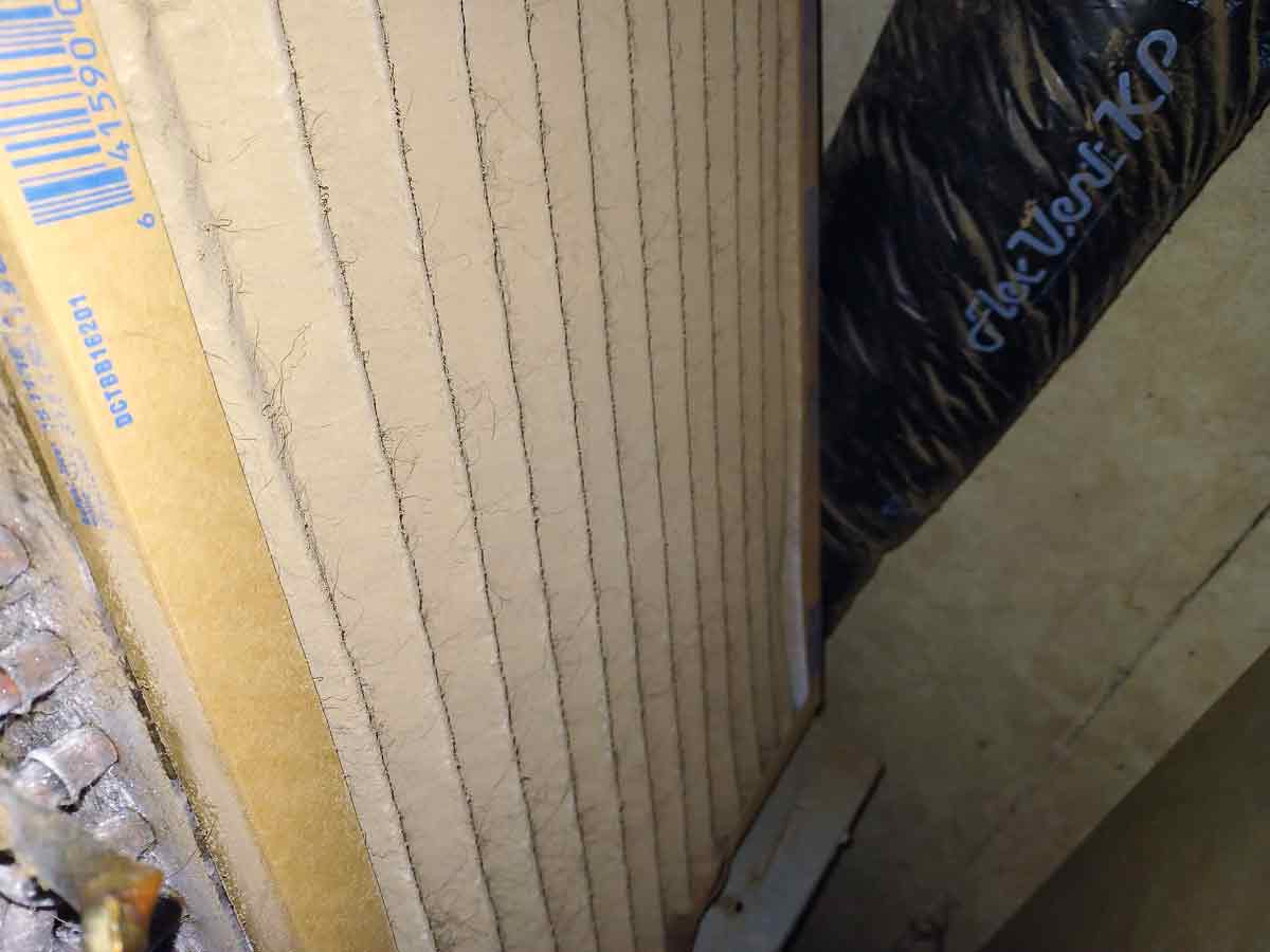

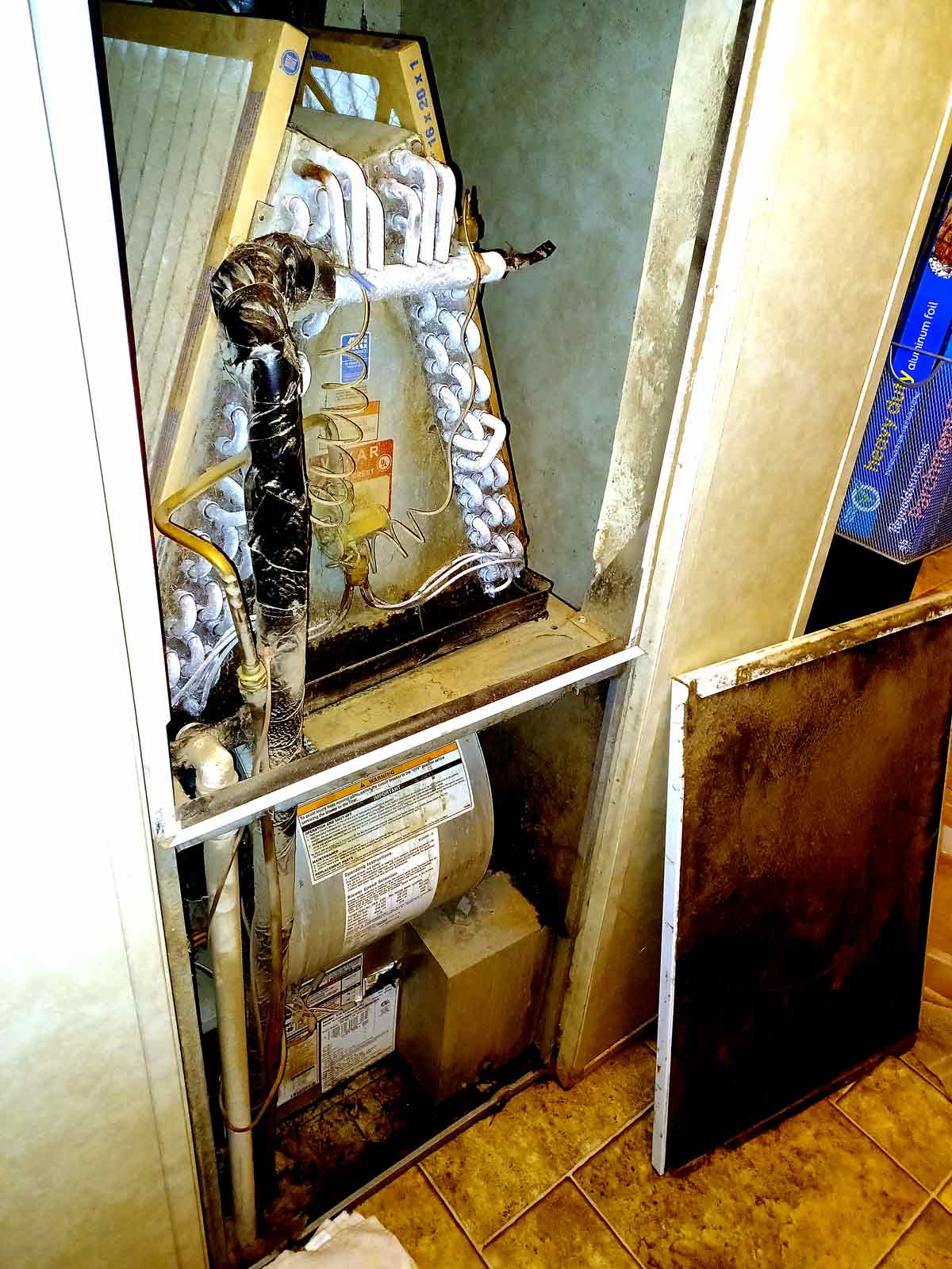

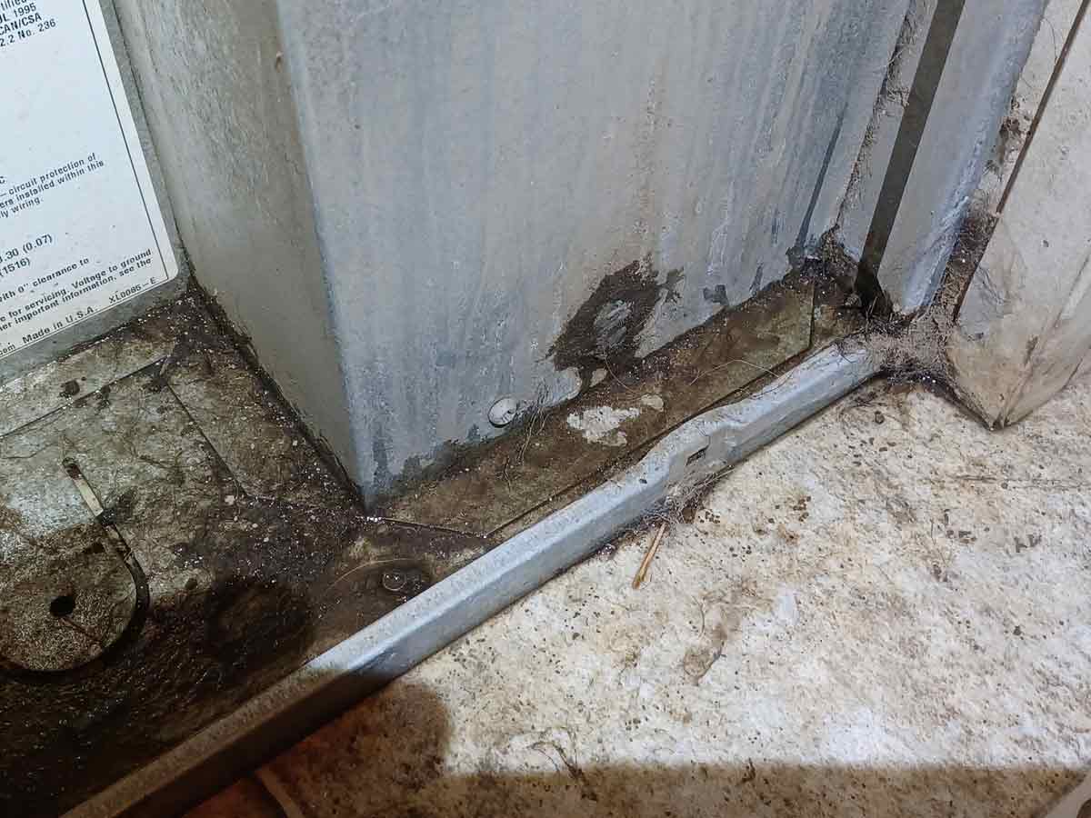

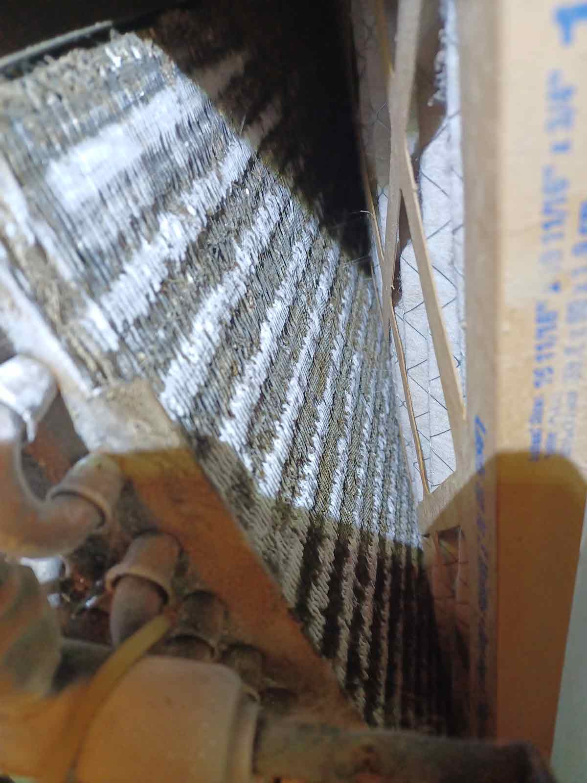

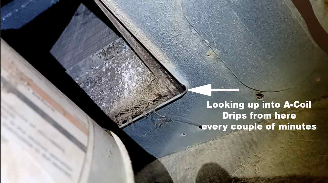

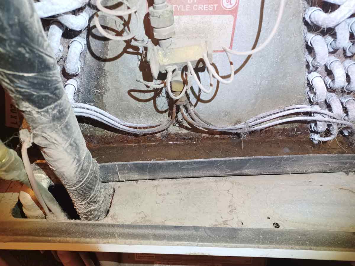

This is a mobile home system, 13 years old. I heard a tapping behind the covers of my coil/air handler compartment (if those are the right terms), and found the floor wet under the air handler. Looking upwards into the bottom of the A-coil, I saw a drop of water forming at the corner that dripped down onto the sheet metal and onto the floor. I filmed one drop and waited over a minute for another to form, then turned off the camera, so it may only be dripping a drop every minute or so.
Coil-wise, my filters were caked with crud (and I had changed them less than a month ago but they're cheap filters and I have five big indoor dogs. And I do NOT keep an especially clean house). When I went to remove the filters to check the fins, I found the fins were holding a good bit of ice, which had frozen the filters to the fins.
This system generates a lot of condensation during the hot Texas summer and the tray under the A-coil usually holds about a half-inch of water, but I'm guessing the dripping coil is responsible for the moisture on the floor, and the caked filters impeding airflow is responsible for the ice, which is probably melting and that's what's dripping.
So is this just a filter problem, do you guys think? Or do I have a bigger problem? I cleaned the fins on the outside condenser a month ago and partially cleaned the A-coil fins (then got lazy). I've got the system turned off now and a box fan blowing on it to try and warm/dry things out.

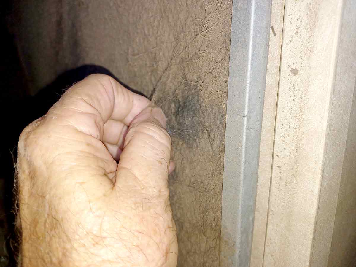

Oh, and I'm also wondering about the batting lining the sides of the compartment that's also pretty well caked with dog hair. I'm thinking that's just soundproofing (see soundproofing-doghair.jpg attachment) but the way the hair is pasted to the batting, I'm wondering if there's some airflow going through there?

I can't see yer photos. Your a-coil is going to drip condensation. It should drip onto some sort of pan or tray inside the unit, with an external pvc or tubing drain going into a floor drain or a condensate pump. Crud will eventually clog the drain or the pans ability to send water to the drain, backing everything up and putting water on the floor. Or the pump isn't pumping. Check the pump if you have one, find the drain and start cleaning the crud out. That's what I would do, but I have ZERO experience with mobil home systems.
Edit: now I see the pics. I would clean the a-coil, new filters as well as the above. Looks like a straight gravity drain, no floor drain or pump.

those filters look quite full of debris . try thawing out & new filters first
Yeah, that's the current plan. I use the cheapest filters at Home Depot. Do you think there would there be any advantage in using a better filter, given that I have to change them monthly already?)
Jim greengo
Sep 3, 2018
7,415
Behind my house
Pull those nasty filters out 1st,and let unit thaw out if its iced up.
Then I'd say pull out the blower and squirrel cage,soak down top and bottom side of A coil with no rinse coil cleaner and let it dry out to see how it looks.
Repeat process till coil looks clean then put it back together with clean filters .
I'd also pull out the hose barb on condensate drain coming from coil pan and clean it out,also blow through the drain hose.

After drying things out for an hour or so, I left the filters off and turned the system back on a half-hour ago, and the outer A-coil fins are icing up again, as is the copper tubing on the outside of the unit, and the air it's blowing isn't particularly cool (81-82f according to my instant-read kitchen thermometers). Any thoughts on this? I'm beginning to get a bit worried.

...there is no way you're blowing 80 degree air with ALL of the coils frosted like that. You're not trying to operate it with the door off, are you?
You need to clean that A-coil, it's filthy. They have special no-rinse coil cleaner (as mentioned) that you can spray on the coil.
Secondly, is that system really designed for the filters to be placed directly on the A-coil? Seems very unusual.

The inside temp is 83° and the air measured at the register was 81-82°. I'm using a digital food thermometer (two different ones, actually), but that's the reading I'm getting. Yes it's currently operating with the covers off, just as you see in the "Full System" photo attached here,
When I bought the place eight years ago, it had the metallic filters seen in the "First Filters" attached photo. I don't recall why I went to the paper filters, but the system manual (https://inspectapedia.com/heat/Nordyne-E3-AC-Heat-Pump-IO-Manual.pdf) does seem to show the filter placed directly against the coil.
But yeah, the covers are off. Is that why it's icing up again, or did I just not thaw it out well enough? Google suggests turning the cool off but keeping the fan on to blow house air through the system so it does't thaw too quidkly, so that's what I'm doing now.

if the covers are off there's no air flow over the coils and could cause the freeze up. low freon I believe also can cause freeze up but run it with new filters & all covers in place and see what it does ( after thawing again )

At the very minimum, the bottom cover needs to be on. The blower pulls through the A-coil, and without the bottom cover on, it cannot pull any air through the coil. It just pulls air from the room instead. The coil will freeze solid without that bottom cover on.

Thanks a lot, guys. I don't have any clean filters to put on tonight but I put the covers back on and it's blowing 61° air now, 22° cooler than the outside 83° air, and from what little I can see through the louvers, the coil's not freezing up again!
I saw that as I was replacing the cover with the fan on... major suction! Thanks again for your help,

While you are doing all your cleaning, make sure your drain line is clear, too.
I have seen otherwise perfectly-operating systems "leaking" because the drip pan simply could not drain through the clogged drain pipe.
