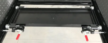

I have a Backyard Buddy which is now owned by Advantage and I just bought the rolling air jack about six months ago. Works great but is not cheap. I have only owned the lift for just under two years but have been religious about lubing the rollers and cables. Hopefully my cables won't fray anytime soon. My lift was assembled here in the States with USA and Canadian steel but I'm sure the cables and rollers are the same as on the Advantage so likely Chinese. They have the same pumps too.
