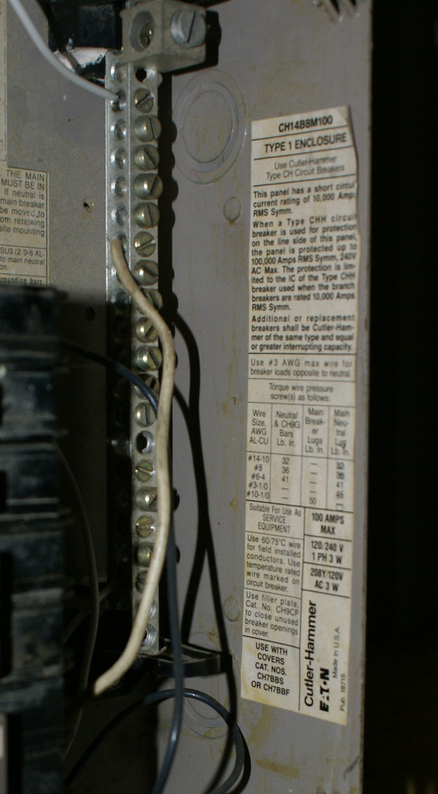

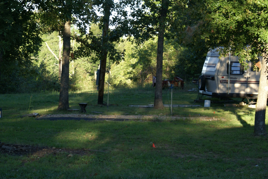

Hello all. I am running power to detached shop on a hobby farm in rural Missouri. For the work, permits and inspections are not required.
Power will come from 200 Amp meter box. Straight run to breaker box will be 130'. Trench will have to be moved over some to avoid corner of double wide (that isn't there yet). I am figuring 160' wire length from meter, through trench, and up to breaker box. Breaker box has 100 amp main that will accept 1/0 wire.
Will be using 230 volt 50amp lincoln 225 arc welder on occasion for equipment repairs. There will be a 3HP 110v air compressor there also. Other electric items will be drills or circular saws on occasion and in the winter we will have a block heater for the tractor plugged in sometimes.
To figure wire size, can I just add up the amps from all the items that I might be using at the same time, or is it supposed to be rated for the breaker size.
The guy at the local supply store suggested 2-2-4 aluminum bury grade cable. Can this be put in conduit?
Voltage at the meter box is 125v. If I have a voltage drop of 10 volts in the wire, does this mean I will have 115v at the shop? Is this enough to keep the motors in the tools happy?
On grounding, can I run a ground wire from the breaker box to a nearby freeze proof water hydrant, or should I still plan on puting in a grounding rod? Should the ground and neutral in the breaker box be bonded? I did notice in the breaker box I have that there is only a neutral bus. Do I need to get another bus for ground?
I know this is a lot of questions, but the more I try to read, the more confused I get. I have put some pictures here, if a picture is worth a thousand words, think of how long this post would have been without the pictures :)

I see a 200A main breaker & #2 AWG AL is only good for 90A,and the Midwest power outlet wiring is positively scary, for all intents & purposes, there is no protection of those conductors, one good thing about inspections is sometimes a inspector catches flunky wiring, back to the shop feed, if overcurrent protecton is provided at the pole there will be no problems in doing what you want.

I would consider the pole mounted breaker to be your service connection and the line to the shop to be a feeder, not a service entrance. Even though there might be a code legal exception allowing a separate ground in this feeder to be omitted, I wouldn't do it. I like to keep ground and neutral separate, especially for rural buildings that might house animals one day, plus the shop is "at grade" and you are likely to be touching exposed metal conduit, air compressors, and the like. This all argues for running a 4AWG aluminum grounding conductor along with the 2/0 2/0 2.
You need a proper ground at the pole. Two 8 foot ground rods driven at least 6 feet apart connected to the neutral/ground lug with 4AWG copper (it can be bare or green). You will also need a proper ground at the shop. Again, two 8 foot ground rods driven at least 6 feet apart. You might as well use 4AWG copper to these as well.
Get a small 200 amp rated main lug panel with at least 4 spaces. Mount that on the pole below your existing meter combo panel. Connect the lugs of this panel to your 200 amp breaker legs with 2/0 copper. Buy a separate ground bar (you can get them at Home Depot) and mount that in the main lug panel. From here on, ground and neutral should be kept separate. Connect the ground/neutral lug in the meter panel to this ground bar with some more of your 4AWG copper. Install another added ground bar in the shop panel and connect the 4AWG copper from the building ground rods and the 4AWG aluminum you'll pull through the conduit.
Install a 100 amp 2 pole breaker in the main lug panel and connect your shop feeder to that. You can add a separate 20 or 30 amp breaker to the other two spaces and have a second feeder to supply your camper or mobile home in the future, or step it up to 100 amps if you build a home, second garage, or whatever.

Oh, by the way I just noticed the picture of the panel in the barn, looks to be 100 amp, you will need to put a main in that panel, or a single disconnect on the outside before it goes into the panel. A ground bar will also need to be installed in that panel.
