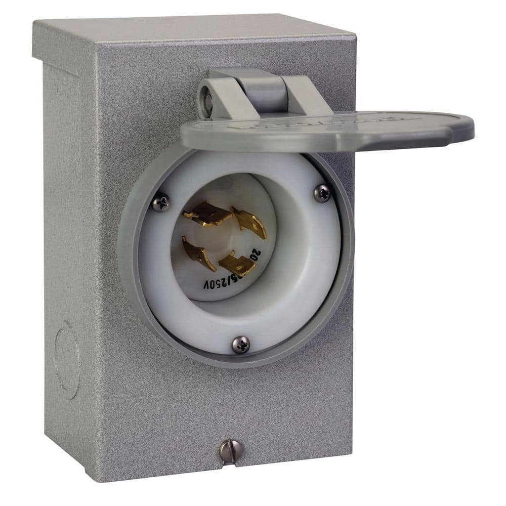

How about this feeding two 120v circuits, if they don't want extension cords running around?
Reliance Controls 20-Amp Power Inlet Box,
SKU# 202216492
