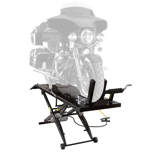

There a perfectly suitable pneumatic lift table for motorcycles. The company offers side panels for lifting ATV and snowmobiles. I bought a Wells Cargo trailer with one of these lifts inside. I made one call and sold the lift for $400 an hour later. The price has gone up considerably since the covid cloud passed by.
