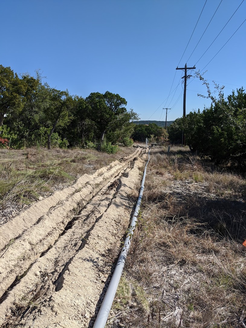

Well, now that the shop is up, gotta power up a house.

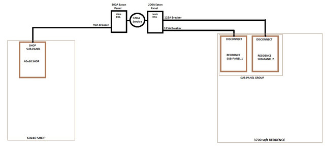

My property has a 320 amp feed - to get this, you need to build a panel "bank" to their specifications, as shown..
The panels are Eaton and take BR type breakers. Largest BR breakers are 125A - BR2125. I need to use one of these main panels to feed 2 "sub-panels" at another structure. It's 277' of hard-trench (rock saw needed) to the residence that I'm powering up.
Why am I doing dual feed?
1) Limitations of the Eaton panel
2) I'm going to do an ATS/genset that only covers one panel.
If absolutely necessary, I could replace the Eaton panel - would need a recommendation.

  • 36" deep x 6" Trench cut by rock saw
  • 2 x 2" PVC electrical conduit
  • Circuit length: 277'
  • Breaker: 2 x BR2125 (Eaton) (accepts #4-2/0 AWG Cu/Al)

You CANNOT have more than one feed to a detached structure.
And SER is NOT permitted under ground.
I hear you. I believe there are two exceptions for this, but would like your opinion.
Exception for grouped disconnects:
While 230.70(A) (comment) requires a service disconnecting means, the term “disconnecting means” is defined in Article 100 and addresses not only a single means, but also multiple means that serve together in a group arrangement as the building service disconnect.....
Section 230.71(A) (paraphrase)
... It can be up to six switches or circuit breakers in a single enclosure or up to six switches or circuit breakers in separate enclosures....
Exception for enhanced reliability, IE ATS/generator:
Additional outside supplies feeders or branch circuits shall comply with 230.2(A). be permitted to supply the following:
225.30(A)6
Systems designed for connection to multiple sources of supply for the purpose of enhanced reliability

You are allowed one feeder. That one feeder can have up to six disconnects at the building. The only exception that allows more than one feeder is for different voltage or phase.

Thanks. In that event, I'm going to need to convert the existing panel to something that can supply 200A.
Southwire says 277' is 250 kcmil copper or 500 kcmil aluminum for 200A. 500 kcmil 4 conductors will go through 3" SCH 40 PVC.
