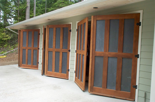

We are often asked about carriage house doors. The great thing about swinging doors is that you don’t sacrifice any ceiling height with clumsy closers and they often look wonderful from both the inside and out. “Real Carriage Doors” has a great gallery of gorgeous examples and they have really inspired me to look for a carriage door solution to my upcoming garage addition. The only issue? I really want a single 16′ opening and that’s a bit of a stretch for most swinging solutions. Anyone have any creative ideas?

Have you considered split folding doors ?
Many of the advantages of carriage doors, not least great aesthetics, and the size of the opening is almost immaterial.

The challenge of the 16' opening has been around for some time. And, you're right, we discourage extra-wide doors because of their structural issues and practicality. There are a couple of options for 16' openings, but new construction always gives you the most flexibility. Folding doors are a great fit for a large, clear opening. And each door leaf will have a nice, slender proportion. Another, oft forgotten way to get a large opening is to use sliding doors. If you have the space for them, they are an attractive solution to this time-tested problem. http://www.realcarriagedoors.com/sliding-garage-doors.php . A little advice as well: Remember about clearance. Folding doors will eat up around 4-1/2" of opening per door pair. So if you are constructing new, you may want to frame for out an extra foot. Good luck on your addition!
