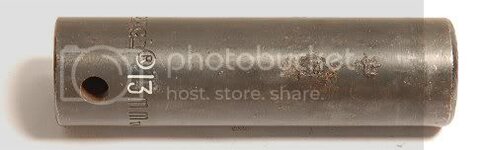

Here is the latest in my series of "tests" to determine the contact areas of various tools. This test uses 3/8" and 1/2" drive 13mm sockets. The 13mm nuts were obtained from McMaster-Carr. The sockets are a mix of new and used and will be detailed with the pictures below. Some of the sockets are mine but most are from your fellow members on the board.
We'll start off with a list of the numerous contestants as always. I'm showing a top view so you can see the condition of the socket for yourself. I'm also showing a side view. I list condition, number of points, drive size, and who is responsible for the socket being in this test. If there is not a name then it's one of mine. This is what the different words mean before the names:

Here are the pictures of the socket's imprints on the nuts. These nuts are Class 8 and from McMaster-Carr. The part number is 90591A161. Dykem layout fluid was used. Each test nut was torqued to 27 ft-lbs using a Harbor Freight torque wrench which is the standrd dry torque of M8 bolts. The test apparatus is a bolt with several nuts on it, a washer, and the test nut. The test apparatus was held by my lovely assistant seen here.
Each test nut was torqued three times with the socket in a different orientation each time. This was done to give an average pattern from each socket. The test nut was then removed by loosening the nut below the washer to avoid any more imprints on the test nuts.
I took multiple shots of all the nuts before settling one the one shown here (with the exception of #26). So, the nuts were handled a little more than I would have liked. Anyways, lets get on with it...

The only one that contacts the edge instead of the face was 21 the Blackhawk socket. As far as I can tell every other socket did not contact directly on the edge though some are close.
Once again, I'll leave you to draw your own conclusions from the pictures.
