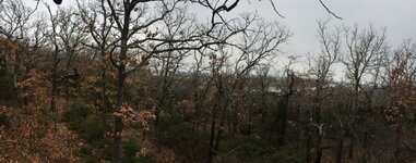

We bought a lot on a steep hillside in January 2021.
You can see there is a view.

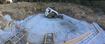

Finished the formwork and built a bridge for the Bobcat to get in.
Almost ready for rebar on September 15.
