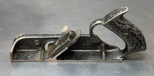

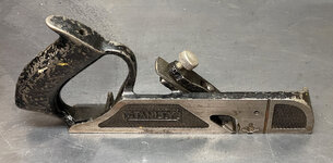

Got this old Stanley No. 191 rabbet plane the other day and decided to do a little restoration work on it. It was already in fairly good shape, so it was a simple restoration. It was a bit rusty here and there, the blade needed sharpening, the bottom/sole needed to be trued up a bit, the depth stop/gauge was missing, and the paint wasn't pretty any more.
I got a replacement depth gauge from someone on eBay, then I bead blasted a few parts and sharpened the blade:
I painted the body and lever cap/clamp, burnished a few surfaces, blued (with gun bluing) a couple of parts, trued the bottom/sole a bit, and reassembled it.
Done, and ready to make shavings.

Got this old Stanley No. 191 rabbet plane the other day and decided to do a little restoration work on it. It was already in fairly good shape, so it was a simple restoration. It was a bit rusty here and there, the blade needed sharpening, the base needed to be trued up a bit, the depth stop/gauge was missing, and the paint wasn't pretty any more.
Hopefully, I cut this quote correctly.
That rehab in that picture is frame quality and perfect for the shop/den/ office wall
I painted the body and cap/clamp, burnished a few surfaces, blued (with gun bluing) a couple of parts, trued the bottom/sole a bit, and reassembled it:
That's gorgeous, I scored a Stanley 78 that was never used a few weeks ago
