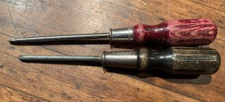

The first thing I noticed about this screwdriver was that the ferrule was large, compared to the wood handle. That's also true for this VACO screwdriver I recently bought, shown alongside a Stanley Defiance handle for comparison.

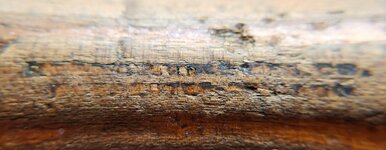

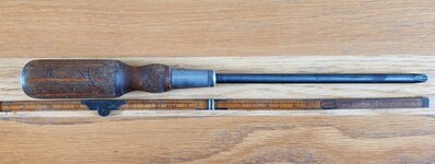

Here's a Reed & Prince, Fearson's cross-recess screwdriver I found some time ago.
It's 14.5" OAL and the shaft is 3/8"
The ferrule differs from others posted here in that it only has "Made In USA" and has knurling on the end instead of a prominent lip.
The shaft has the RP trademark just forward of the ferrule and has what appears to be an "S" or less likely a "5" directly below it.
Does anyone else have a character below the trademark on theirs? Could it be a date code? (BTW, the JWB are the smallest owner stamps I've ever run accross)
The remains of the company name and address are on a single facet of the handle.
I can just make out the first "R", PRINCE, and the CO.
The second line is completely illegible to me.
The tip is in fairly good shape despite someone trying to use this monster to turn a tiny screw.

I agree, but wonder if, due to the other differences, this example is older and would only be Worcester.
Regardless, here is a logo I found:
