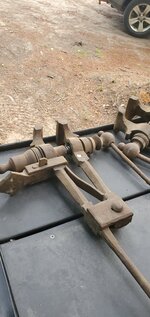

Picked up this post vise. 2 questions. Any one know the maker and what holds the leg on floor? Thanks for any replys . Bill

Picked up this vise today. 2 questions. Anyone know the maker and what holds the leg? Thanks for your help

These vises rarely have a makers name but if the do it would be on the triangle mounting piece.
Once the vice is mounted to a stump, bench, or whatever usually a wooden or steel piece is put under the leg to give it a little support and some give cause these vises were meant to be hammered on.

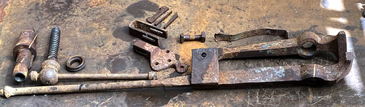

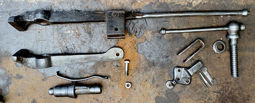

II picked up a small 3 1/2" post vise at the swap meet a few weeks ago.
The screw wouldn't turn. It had a broken table mount plate and the hinge pin that the dynamic jaw pivots on just had a sloppy rivet pounded into it instead of the proper tight fitting bolt. (see photo below):
The screw freed up with some WD40 and very little effort so I was able to break the vise down into parts:
Next I wire wheeled it:
Then I repaired the table mount plate by welding a tap onto it and drilling a hole in it.:
I then discovered what I'd thought was a poorly sized rivet that was used to replace a bolt for the dynamic jaw pivot was actually the way it was designed by the maker .You can see the detent the bump on the rivet homes into when it's driven into place. :
I'm curious to find out who the maker was so if anyone recognizes any of these features please comment below. There are no other names or symbols anywhere. Another distinguishing feature is this grease channel cut into the cheeks (both sides and top) of the hinge area of the dynamic jaw.
The main parts were marked with three deep chisel strikes indicating the blacksmith was making a few of these in assembly line fashion. Mating components like the screw were marked by chisel marks foeming an "X".
After a little work this vise has turned out really well and I'm happy to have it. I've coated it with BLO.

Hey guys, I just snagged another one with a lot of blacksmith tools. In the seller's photos it looked bigger and so did the anvil (posted in the anvil thread) but it all came home with me anyway.
Of coarse I had to tear it down and clean it up to get it working smoothly and did I get a pleasant surprise.
Of interest is the fact that the pivot plate for the dynamic jaw is riveted in place as well as forge welded. I'm no expert on these vises but I haven't seen this done before. Is it a Peter Wright thing? Also note the tips on the screw handle, they are kind of pointy.
I don't think the spring is original, I think the PO found this one and made it fit. (I found a 1/2 a broken spring with a pile of rusty stuff)
Here's another interesting thing. Notice the thin metal insert in the opening where the main screw nut fits. There is a thin band of metal welded in there which I think was added to align the nut/screw apparatus so the dynamic jaw lines up correctly with the static jaw. It cradles the bottom and wraps around one side right up to the top (one side only). I always thought this alignment was controlled by the pivot pin.
You can see how the spring looks too long in this last shot. I'll make a new one.
