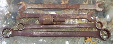

I've not yet tested this but I'm going to soon. similar results to E-rust and WAY cheaper. It's doing the same thing - chelating the rust - and the ingredients are easy.
CAUTION -the guy in the vid mixes this up in a wide flat tub - for a reason - A guy on another forum did it in a bucket and it fountained out during the mixing! initially you need Personal Protective Gear - after its mixed it's not particularly hazardous.
The formula on a 1 liter basis:
1 liter water
100 grams Citric acid
40 grams of sodium carbonate - washing soda
OR 63 grams Baking soda
OR 30 grams of caustic soda
Add some dish soap as a surfactant - Dawn
OK I said I was going to test this Home brew DE-rusto, and I've started:
Supplies:
A fairly flat tub so it does not become a "Foam Cannon", 2 Liters of water (double batch 1L isn't much...), 200 Grams of Citric Acid powder, 130-140 grams of baking soda, and Dawn for the surfactant:
I'm doing this outside so any mess is an easy hose down, adn any fumes are blown away (only CO2 is supposed to come out, but if you get a citric acid solution's fizzing, there will be aerosol particls, so...)
Water in the tub:
Citric acid added -pretty quiet:
Ready? -Note the PG and I was also wearing a face shield and mask:
GO! lots of fizzing and foam, stayed well inside the tub.
After some time it settled down and some gentle stirring, I "tested" with a pinch of Baking soda, very slight fiz, so I gave it a PH test, down at ~ 4 PH so it should be good to go.
Then I added the Dawn and stirred it gently again:
The suds is from the Dawn.
Ready for some test subjects:
Now its a waiting game - I usually do this in my USC, but this tub won't fit and the long pieces are too tall:

Checked on the De-Rusting a couple of hours ago. I need to check again but most was gone then.
Supplies:
Water in the tub:
OK, Test results were good! Home brew "De-Rusto" works!
The solution is clean and ready for more work -First use of E-rust and its filthy:
and the results about 6 hours later: - I removed them, lightly brushed them off under the tap with a brass brush, the broken Plvmb only got a light "buffing" under a fine 4" wire wheel. After the pic I sprayed the inside of the chuck with WD-40 to remove water and ran it full cycle a couple times. very smooth!
and before for an easy compare: - They aren't perfect. but as the buffing of the Plvmb showed not a lot more needed!
