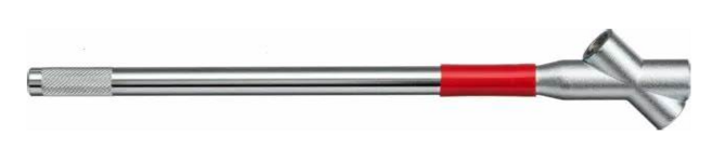

I have the Wise power handle, which is a wrench extender and torque amplifier for hex keys.
Its my understanding Wise keys are made by Fujiya in Japan, who also makes keys under their own name.
Anyone have experience with either Fujiya or Wise? They seem like very good quality.
The double ball end WBP-2900LL set has caught my eye more than once.
