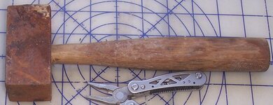

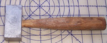

Sounds cheaper than the Evaporust I've been using
$10 US for two pounds, which, when reacted with a sodium-containing base costing a few cents, yields 2 gallons of great rust remover. I finally gave up on the batch I made two months or so ago, after lots of rust removed.
Heat and the ultrasonic cleaner speeds things up a LOT. I'm getting great results from a quick buzz of 1/2 hr in hot solution.

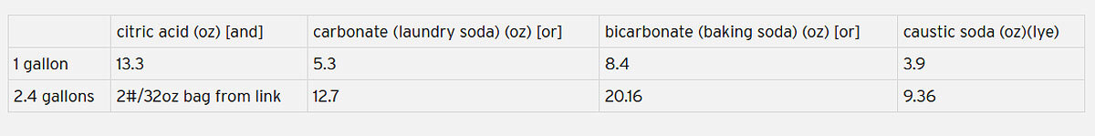

Got a recipe for that BH? I don't recognize either of the two ingredients you mentioned. (Yes, I'm sheltered)
Beerhippie
Oct 13, 2023
10,715
Far NE Oregon
One more time:
The first two bases listed are washing soda and baking soda.
Always add acid to water. Put the citric acid solution in a larger bucket--for two gallons, use a five-gallon bucket. Add the base of you choice sloowly as the reaction can be a bit of a show. Do it outside! The gas released will be CO2 if you use one of the carbonate sodas, H2 and O2 if you use lye--O2 + H2 is explosive, so maybe don't smoke while you're making the solution.
Nice thing about this is that the ingredients can all be food-grade if you use baking soda. Dispose of it when spent by dumping down the drain, or diluting a bunch and spraying it on your lawn as an iron supplement.
