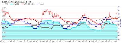

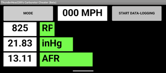

I installed a Carb Cheater on my 67 Cougar today, coolest thing ever. I don't have any pics but its basically a controlled air bleed valve with a little air filter, a small brain box with GPS and vacuum sensor, and an oxygen sensor. You replace your carb spacer (or add one) with his, it has a front and back port and passages inside to direct the inlet air to each barrel that you connect to the air valve. This device lets me see and set an idle and highway AFR, control a couple of switching outputs and mixture based on RPM, set a rev limiter, and see vacuum level, AFR, speed, RPM etc. on an android app. You can also use it for controlling a line lock or controlling a flame setup among other things with the programmable outputs. And you can graph everything out and look at it later if you want to help tune. He sells a little square device you can use for a permanently mounted customizable display or any android device works. It uses Bluetooth to talk to the device. My old **** phone worked fine.
When I first hooked it up I could see it was opening the valve about 30% because my idle was too rich, I tweaked it a little to get to the default 13.5 AFR and the valve doesn't need to open much at idle anymore. Then on the highway I could see when I was cruising at a steady speed I was sitting at around 12.3 when the default is 14.5, so it opened and kept me at 14.5. Some people go leaner on the highway but that seemed good. I need to go down a jet size I guess to get closer without it working. You can set those AFR values to whatever you want, and also use it for a choke if you set everything up with that in mind. And easily turn the auto tune feature off/on with a button push to help see what's happening, and it always shows what percentage the air bleed is open which really helps. So now changing temps and/or elevation will be automatically compensated for by it, which is pretty neat. My AFR was also dropping down to about 11.2 under hard acceleration, which is lower than ideal for peak power, so it opened to help get that to about 12.7 when I floor it, I could feel the difference turning auto tuning off and on.
Its as handy as a normal AFR meter for tuning your carb but with auto tuning and a bunch of other neat features. And if it dies you can still drive fine, unlike some of the buggy fuel injection systems I've watched my friends fight with on their muscle cars.
The base system is about $300, I think the one with everything is $400. This is a decent amount of money but I really like the carb I have and to do fuel inject I would be around $1k with the pump and everything else to make it work. Plus if this dies I can keep on driving.
Here is the webpage and pics/details. https://thecarbcheater.com
Edit- here are some pics I stole from the series of tubes, there are a bunch of different modes/views you can choose on your phone or you can get the little display that is customizable -
It's pretty cool to see that somebody brought this concept back to life as an aftermarket product. Thanks for posting this.
