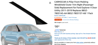

There is a FORD recall on this trim item...
I took my wife's 2017 Explorer in to the dealer because the RH side a-pillar plastic trim became partially disconnected...Flapping in the wind...
I got tired of waiting on the FORD recall...
I've been waiting for over a year to get a call from the dealer that the part is available for the install...
The OEM supplier for this part has vacated the scene... FORD is saying they are trying to establish a new source...
Amazon to the rescue... Part was a perfect fit
Took me about 1/2 hour to do the repair...
