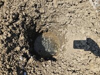

We finally decided to tackle the firewood shed project. While not the most pressing project we did need to get it done. With the wind we get we can't keep a tarp on the woodpile so it is starting to breakdown. And we already had most of the material here already, so getting this project done would get it out of the way.
This is where it's going:
Once I get the tractor fired up it still works pretty good. But it's a PITA having to plug the coolant heater in to start it when the humidex is over 90 F.
Once the gravel was out of the way I could dig the post holes. This is where my carefully laid plans got blown to pieces.
I had lined everything up for the weekend prior to and the actual July long weekend. The in-laws where coming down so they could watch the little ones/provide help, I wasn't working, and I had the rental company drop off a post hole digger and cement mixer. The thinking was if I could get the posts set the weekend before, I could spend the long weekend building the shed and have it done and off the list. It all sounded so good, just knock out this project quick and move on to something else....
...I'm sure you can guess where this is going...
Well would you believe that the night before I was to dig the holes, after being quite dry for a month, we got a 1.5" rain in 30 minutes. At that point I had the equipment already here, so I went about digging the holes the next morning hoping that the ground would have soaked up most of that rain since it was so dry. Alas, my hopes were dashed.
After a few days the water did drop and I was able to get the posts set.
