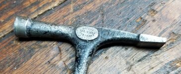

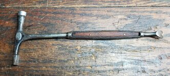

Super excited to run into this antique (ca. 1872) tack hammer/puller combination tool this morning at my flea market. Venerably old, well-made, and handsome - and vying for personal 'Find of the Year' honors for me.
My first research stop was DATAMP, where I plugged the first date marking ("DEC. 10. 1867") into the search field, revealing US Patent 71,986, for an Improvement in the Manufacture of Tack Hammers, awarded to Thomas Conklin. DATAMP page here.
The patent was not assigned to anyone else, but he lived in New Britain, CT, and, according to the DATAMP steward, the design - for a hammer made from a single cast piece of malleable iron with a hollowed area, was "incorporated" by Stanley into several different hammers.
The other date marking ("FEB. 13. 1869") is apparently a mistake. The Re-Issued Patent, RE3,308, was awarded on February 23, 1869.
Note that neither the patent or the reissued patent look like this hammer. More on that in the next post.

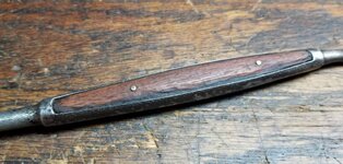

The brass rivets/pins showing about an 1/8th of an inch illustrates the depth of the wear on the wooden handle inserts over the years. This view also shows the solid but hollowed design and casting.
