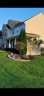

They don't jump..
Case in point
And spent a bit of time tearing out stuff we planned to replace it with things that fit better.
In this case a volunteer crepe myrtle got moved from the back yard to the front yard. No idea if it's going to survive. I didn't realize it sprouted off a main tree root until I had it mostly dug up. Couldn't stay where it was anyway.
Pulled thus out if the bed. It was supposed to be a small daisy, ita about 6-7' across.
Took the opportunity to add a bit more stone to the wall and bring up the grade of the bed by a foot or so. I didn't do it at the time i built the wall originally because of the existing plants... they all came out.
Not my best work on the dry stack wall this time.. but its in and hasn't fallen over.
I had just laid the wall around the slope originally, and just sort of filled in some areas with mulch to look more level but not kill the trees.
