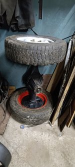

I've made some progress on my tractor. I had some old wheels that I found a few years ago in a landfill. I pumped them up and it turns out they hold the air. For now, I will use them to build and test the tractor.

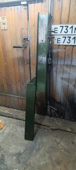

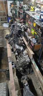

Minor changes to the tractor. I bought the material for making the frame, I managed to find only 1.5 meters channel and about the same amount of an I-beam, also 10 cm. I had to shorten the gimbal as much as possible, otherwise the tractor turns out to be very long. So far, I've only fixed the rear axle and transfer case. It turns out something like this, and it's not a fact that this is the final version, there may be some more alterations.

I worked on the tractor frame a little more. Now we need to fix the engine and think about how to make the front axle. I originally wanted to make all-wheel drive, but unfortunately I have axles with different gear ratios, and the transfer case that I use does not allow me to turn off the front axle. So I abandoned the idea of all-wheel drive. I also got a hydraulic pump. I bought it inexpensively for about $12. I think this is a good price for a pump made in the USSR and which was stored in grease.

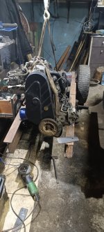

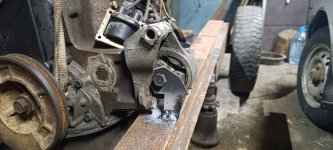

The New Year holidays are over. I returned to the city, worked in the office again, and continued working on my tractor in the evenings. I've made a mount for the winch, lifted the engine, and am starting to attach it to the frame. So far, I'm doing all the fasteners for marking. After I put everything in place, I'll take everything apart again, weld all the welds well, paint the frame and continue the assembly. At this stage, the project looks like this.

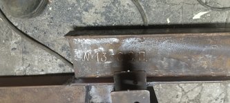

I disassembled the tractor frame to properly weld all the fasteners. In the process of rust removal before painting, I found a number, now it will be the number of the tractor frame ;). We have severe frosts, and the temperature has been below -20 degrees Celsius for several days. This is what the smoke from my neighbor's garage chimney looks like.Номер.jpg
