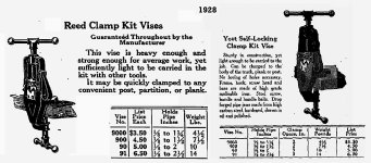

colmal: Reed classified their #90 as a Kit vise. It was meant to be carried to a jobsite and clamped to whatever was handy.
REED also marketed something they called a Strap Vise. It really stretched the definition of "vise". It had no jaws. The user tightened the "linen webbing" strap by advancing the screw.
Can a proper vise really have parts made of linen? lol​
