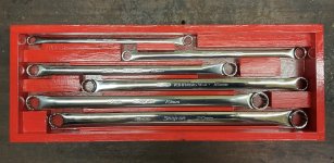

My most used are probably the double box end / ring spanner. Generally “shallow offset” but I have a variety.
Once you own a few double box end, some double open end are the perfect complement. Sometimes the open and are needed for a particular fitting, sometimes they just work for speed.
I suppose the other option is to go for combination. There are a few considerations here, one of which is the sizes of fastener you work with. If it’s Imperial, the box ends (without skipped sizes) work perfectly. If metric, combinations make it easier if you want to skip some sizes.
I tend to use combination in my (metric heavy) “road box” and they work just fine.
Here is my “go to” wrench drawer. I organise a bit differently from some. Instead of having one “wrench” drawer, or maybe two for Imperial and metric, I have a “mid size” wrench drawer, within which I keep both box end and open end wrenches, but in SAE, Metric and Whitworth.
Bigger wrenches I store elsewhere (individual boxes for SAE, Metric and Whitworth) ditto smaller wrenches, which are better off in a small drawer.
With regard to other styles of wrenches, I probably have most of them. Some I use a lot, some less so.
The regularly used ones I keep to hand in my shop. These include flare nut wrenches in the popular sizes (not many for automotive / workshop use), ratcheting wrenches (again in popular sizes) and metric extra long / aerospace box end wrenches, which I find invaluable in some circumstances.
All else sees less use, and in honesty I don’t even store these in my shop. If I’m going to need a short box end, or an aerospace box end in BSF, I usually know in advance and bring the appropriate tool. I store these in ”sets” in plastic boxes so it’s easy to grab the appropriate box. I also have a drawer with things like French style socket wrenches, which I find useful to “grab and go” sometimes.
I do find it’s worth having some 6 point box end. Sometimes you find that uniquely horrendous combination of a butter soft fastener that you can only get a flat wrench on. Ditto things like box spanners. There are some jobs where only these will fit (some lathe leadscrews).

The O.P. asked about different wrench types, and what was useful, so here are a few patterns I do find useful. These are mostly from my shop, so used fairly often.
First off, flare nut wrenches. Borderline essential. But… before you go out and buy a “set”, probably with many sizes, think carefully. Money might be better spent buying a couple of different patterns, in sizes you do use. Snap On, Facom, and Hazet all offer more than one pattern of these. 80% of my automotive use is 10mm. 9 and 11 shown cover probably 95%.
I do have a lot more of these, but they tend to be for more specialised uses, working on machine tools (air chucks, tooling, coolant lines) or classic vehicles so are not needed in the shop regularly.
I mentioned short double box end. I developed a liking for these working with my Dad, who used them often. I have these in Metric, SAE and BS.
Finally, my all time favourites, the aerospace style / high performance wrench. I absolutely love these, and they handle pretty much anything my double box ends cannot. These Snap On are stupidly expensive now, but I got these on a deal, don’t abuse them, wipe them down, and store them carefully.
Although more specialised, both Facom and KTC offer versions of these.
I’m fortunate to own a set of these in BS sizes as well. Hard to find in BS these are Blue Point (pre Snap On) also and are quite superb.

Interesting to see the Snap-ons up close. The open-box end appears to be asymmetric, presumable for clearance. The open end I suspect is thicker than a normal open end to spread the pressure.
You are exactly right.
You essentially have two options in the same tool, one being a deep open ender, which is really for round fittings with flats milled on. and the flare nut end.
The merits of Snap On, and the relative value, can be debated at length, but these particular tools are superb. The flare end is very close fitting, there is no slop, and I could probably be convinced that these wrenches are either made from different steel to the regular, or heat treated differently, as there is no flex in the jaws at all.
