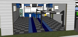

In related news, I think I have a Swisstrax Ribtrax floor design I like.
It is a total of 395 15.75" tiles. If their price hasn't changed drastically this will be in the range of $2500 CAD shipped to Calgary.
I expect this is a spring activity still since I need to finish drywall finishing and painting first (which are quickly climbing to the top of my priority list)
