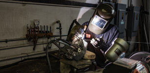

First though I needed to repair the tanks.
The last ride I did the gas caps were just rattling around and I could barely keep them in - the the threads weren't holding. I took one apart to measure and it turned out the "threads" were just Home Depot 1-1/2" pipe plugs bolted and glued to a gas cap. You don't use tapered threads for a gas cap - you just don't. I tried to make a stainless cap but it just galled.
The only option was to order new aluminum caps and bungs, cut out the necks and weld them in. Being that my aluminum welding is not a sure thing I thought I'd find a pro who I could also get some tips from. Luckily a friend put me in touch with Heath Knapp who used to do aerospace welding, then worked for MotoCzysz and now works for Outside Van - all top tier.
I brought a hood and got to watch up close and I was sort of amazed as it looked just like every video I watch on YouTube - effortless. Thinking this was my opportunity to learn the secret settings to nirvana I asked what his electrode negative setting was, "Oh, um, I keep it at 80 I guess..." Do you change it based on the weld, or inside or outside corner? "Um, no. Just 80" Oh. Well what Hz are you welding at? "Oh, I weld at 150hz." Do you change that for different projects? "No. Haven't yet" Okay, what's the reason? "I like the way it sounds. Anything below 100 is too flashy and anything higher than 150 is annoying and buzzy. I like the way 150 sounds the best."
So there you have it. I learned that to be a good welder your settings mean **** all and you just need to spend half your life under the hood.
And Heath is damn good. The one thing I did learn was by watching his amps - thank god he varied those. He would manually pulse the pedal laying down what was essentially a series of stacked tack welds with the amps going from 170-180 and then backing off to 100. When he'd regrip the filler he'd drop the amps to 50 and just reposition. That was awesome to see and explained a lot. Never knew you could pause like that. For that cap he was steady at 230amps but kept the puddle from getting too hot by feeding the rod a lot. Each ripple was about a 1/2" of filler rod fed really aggressively. It was also illuminating.

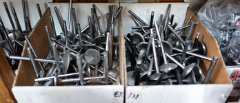

Ben discovered an amazing machine shop just a few blocks from his house and after I pulled the engine apart I thought I'd take the heads down to have them look at it and see what they thought.
Baisley Hi-Performance is a pretty established, famous and unknown to me performance shop. They do work on many bikes but mostly Harley's. I had just come back from taking the kids to a Dr's appt when the father, Dan, called to tell me what he'd discovered on my ebay R100RS heads. Essentially the seats were in good shape but the valves were cupping. I explained how I'd like to have the heads done but I'd need them by next week and he said if it was okay to start he'd work on them today. Heck yeah. Can I come take photos?
There is almost nothing I'd rather do than hang out in a machine shop. Heads are stacked on heads on shelves and the shop has the feeling of being neat but dirty. All the stations are swept but the work is piling up and every cabinet shows the grease stains of a million touches.
And mixed in with all the machines is Dan and his son Ryan - both slight framed and bright eyed. Typically there's signs in most shops with a red line that customers can't pass - or worse a waiting room. Here the door is unmarked but unlocked and opens into the actual shop. I understand a lot of machining but this was a world of machines and tools I've never seen.
Dan had cleaned my heads and just taken them out of the oven after removing and replacing the valve guides. The first thing with the new guides was to ream the guides to fit the new Black Diamond valves that we were going to put in. Here he's reaming the guide with a gimble mounted adjustable reamer in the drill. Three or four passes and then he checks it with a gauge sized like the valve stem, adjusts a tenth or two and does it again until the feel is perfect.

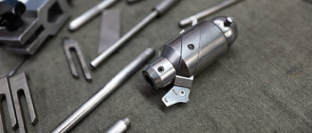

The head is mounted in a trunnion table on the valve seat cutting machine. My heads are stamped with my initials and the date they came in. The trunnion table weighs 500lbs but with the press of a foot switch is floated on air and moves as easily as an air hockey puck. It's amazing.
Once it's close the table is moved to center the first valve guide to within a .00001. That hunk of aluminum is gently tapped and the dial indicator shows the movement.
Once centered the table is leveled in both axis with a level on par with a Starrett Master Level. Again, to tenths.
When all the setup is done for that one valve in the one head a special dial indicator is used to show how far out of concentricity the valve seat is.
This specially made cutter is spun via the ball head and pins but is held by the valve guide with a precision ground shaft.
Every valve, every bike and every seat have different profiles and every profile requires it's own cutting tool. Dan says stones are faster but not as precise.
The cutters geometry is checked under magnification and adjusted to the spec of the valve.
I was surprised at how slow the cutter spun. One revolution took between 1-2 seconds and the only cutting fluid was the cleaning solution from the parts washer.
This and another million details caught my eye. Nothing, not a single thing in this shop has not been optimized, customized or tweaked to make the job better or easier. No one bends their cleaning brushes in a Z because they're easier to grab, use and sit better in the solvent can. Dan does.
The single cutter cuts several angles to match the valve. The cut is biased to be a tenth high on the outer edge so that it will seat in flat after it's been run in. I have tried to work in tenthes - the best I can do is to manage a half a thou if I'm lucky. Dan lives in a world of tenths. He can feel tenths.

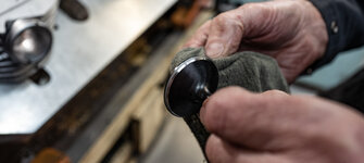

After he's satisfied with the cut of the seat it's time to lap the valve in.
A small amount of grinding paste is put on the valve and a small suction cup with a handle is attached to the face and the valve is set into the head and Dan vigorously spins the valve back and forth on the seat for maybe 15 to 20 seconds.
One valve done. The entire process starts over with moving and leveling the table.

Of all the things, what stood out to me the most?
His hands.
Those hands have knowledge. Things we'll never know. Feelings to fine for "us" to feel.
Almost a sixth sense.
Touch. Tuned by years of doing.
His hands.
Right? I guess it's obvious that I saw that too and my photos concentrated on that. So much knowledge. Dan's father was a machinist as well and his son Ryan works by his side in the shop. Three generations of knowledge. No CNC can match that.

The top hole was misaligned a bit so I welded it up - my first practical weld on aluminum on this bike. I can see how the porosity of the case makes it hard. It worked though and the whole thing only took about three hours.
