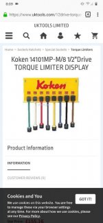

Those Koken and KTC wheel sockets are sweet, but I like using torque sticks to not go over torque. Anyone use them on a torque stick, seems it would be pretty ridiculous in length? There's a youtube review that claims the koken has a built in torque limiting shaft but their literature makes no claim of that.
Sent from my SM-T720 using Tapatalk
Negen
Jul 15, 2015
1,909
Seatltle WA
Koken has you covered.
Sent from my ONEPLUS A6013 using The Garage Journal mobile app
