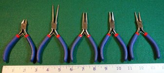

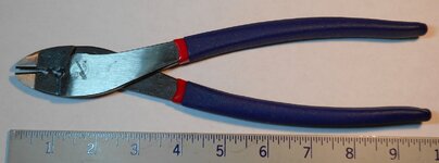

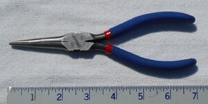

They also make pliers. Lots of pliers. Lots of pliers for Lots of other people.
4018 Proamerica 6-inch needle nose
4020 Proamerica 4-1/2" curved-jaw needle-nose
4028 Proamerica 4-3/4" needle-nose w/cutter
4040 Proamerica 4-1/2" angled flush cutter
5013 Proamerica 7-inch needle nose

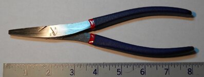

5022 Proamerica 8-inch duckbill
5030 Proamerica 9-inch linemans

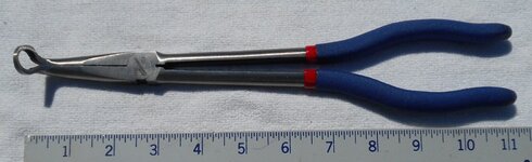

30,058

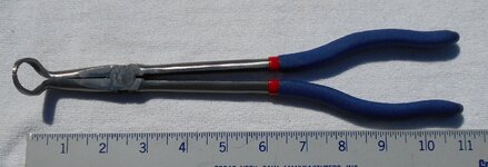

Proamerica 5049 11 inch x 3.4 inch ring-nose pliers 01.jpgProamerica 5049 11 inch x 3.4 inch ring-nose pliers 02.jpgProamerica 5049 11 inch x 3.4 inch ring-nose pliers 03.jpg
5049 Proamerica 11-inch x 3/4" ring-nose pliers

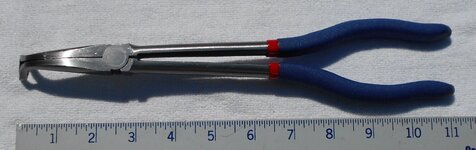

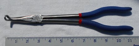

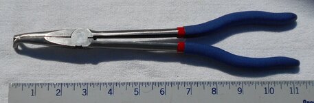

To the best of my knowledge, ProAmerica is/was stamping out those 11-inch needle-nose (in various styles) for Tekton, Proto, and a couple other companies.
You might want to check out these ProAmerica 11-inch diagonal cutters
The best prices I've found on ProAmerica on other pliers have been from Bowers Tool
F
30,058
Yes, they are ProAmerica, made for Tekton, with the Tekton branding and part number buzzed off.
The seller cannot tell you that in the ebay ad because of a contractual agreement with the vendor - that's all in the fine print in the ebay listing.
No, they are not made in China. None of KAL or ProAmerica's products were ever made in China (PRC or ROC). Some older KAL stuff can be found that was made in Japan, but that goes back a ways.
