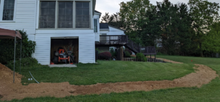

Hi. I've never pulled any major wires before and was seeking some tips and advise. Will be pulling 4 wires (3@ 1/0 xhhw-2 AL and 1@ #4 awg xhhw-2 AL) though a 2" conduit. The new Barn subpanel is uphill (about 6-7ft in elevation from the House) if that matters. I have a drawing to scale (attached) showing my rum and planned conduit bodies. Once in House basement I am transitioning to a 1/0,1/0,1/0,#2 ground SER AL cable to my main panel.
Where would you start the pull? Would it be done in phases then hand fed in places? What kind of pulling implements? etc. Thanks!Wire Pull-1.jpgWire Pull-2.jpg

Got it. So I think if I have my spools in the basement, might be best as it's a straight shot into the conduit. Then would I be pulling 1st through the screw cover of the 1st conduit body outside Barn? Then hand feed/pull the last 20' into the panel box? in a couple of phases? Thanks!

**** a string through with a shop vac, use the string to pull a rope. Pull from the house, feeding from the LB. When there is enough wire in the house, pull it from the B to the sub.
Do you mean when there is enough "rope" in the house then attach wires and pull back through the 1st barn LB ? Thanks.

Pulling the wire out of that LB and then feeding it back through is going to ****, especially with an LB right on the other side of the wall. You may have to unbundle them for that.
I would definitely not tape the bundle up along the run. You will want to be able to pull on an individual wire at times and that will prevent it.

So how would you pull this? Thanks

Instead of a LB, do you have room for a junction box on the inside? It would have to be big.
The reality is that I would probably do the run the same as you and just swear my way through it.

LOL. Yes I have room. I already have a 12x12x6 box for my basement transition from individual wire to the SER cable. But how difficult would be to push each wire though the 2nd barn interior CB then maybe snake and pull individual wires separately into the panel box. It's only 20'. Rather than pulling all 4 at the same time the last run into the panel box?

Should/can I situate my junction box, as in my drawing, and have the 2" conduit run directly into it? I am going to have a 3" PVC sleeve through the foundation wall, maybe I'll need to padout the back of the box so that the sleeve can protrude into/past the wall abit. Then put a terminal adapter for the conduit to connect into the junction box.

I drew in where you can probably eliminate some bends and just do a long bend with the pipe. You can lay the conduit on the ground and get an idea of the bend that you can easily do and then trench that path. I used 1.5" conduit with slightly smaller wire so could be bent more than 2". Eliminating sharper bends will make the pull easier but you will have to see what seems reasonable for your run given what you have to work around.

I get your point. But I'm going to dig this trench (54" deep, water at bottom) myself. Never done this before but I have an old sizable backhoe. Not sure if either of us are up for the task. Was going to start the other day but my starter finally went. Hopefully a replacement is coming tomorrow and praying it jives with my tractor and works good. Getting back to your drawing, I might find it difficult to dig the trench in "not straight" sections. Otherwise it makes sense. Thanks

Even the 2" pipe is pretty flexible. I made this entire curve in a 4" wide trench without using a single 45 or 90
Nice. but given the dynamics involved i.e. me as the operator, 24" wide bucket, 54" deep. I think I need to make straight sections with distinct angles.
Just digging out a corner a little more may be enough.
This stuff helps make pulls a lot easier.
Plus the electrical doesn't need to be anywhere near that deep. Drop the electrical in once you have most of it back filled and it will make it easy to widen certain areas
I think you are putting a water line in the same trench and not saying you expect to have some ground water in the trench (I have worked in some areas with very high water table). If you plan to fill the trench part way and then lay the conduit you should be careful - the fill will settle a lot and may break the conduit, especially at the ends where it has a hard connection that isn't going to settle. On the barn side you can do a slip coupling but not on the basement side. Better to do a ledge on the side of the trench to support the conduit but that will be more difficult than making a curved trench. With a 24" wide bucket you have a lot of room for bends even with abrupt corners. A trencher would make quick work of this and might be worth the rental. Unless you have a lot of big rock the whole thing could be done in a couple hours easy.
