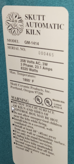

So in another thread I mentioned I got a kiln but it's 208v 3 phase however my garage is 240v single phase. So getting a quote from manufacture to do the proper swap of everything that is needed and it's just under a grand for all the parts.
Someone else mentioned getting a buck boost step down transformer and I have a question on getting the right thing.
Below is the data plate from the kiln. 208v, 3W 2phase, 23.1 amps and 8320 watts. Manufacture suggests a 40 amp breaker (even though the plate says 23.1 amps)
When looking online at buck boost transformers, most of them say Power Rating of x.x kVA and don't mention watts or amps. Is there some conversion from amps or watts to kVA?

A transformer with a 240v primary and a 208v secondary would need to be nearly 10kva to run this kiln. With a bucking transformer we only need 1.5kva. That's because only the secondary of a buck/boost transformer needs to handle all the current of the kiln.
240-208= 32 so we want to lower the voltage by 32. We can that with a 32v secondary. But how big does it need to be?
8320w / 208v 1ph = 40amps so 40a through the secondary of the transformer.
40amps x 32 volts = 1280va closest larger size is 1500 or 1.5kva
