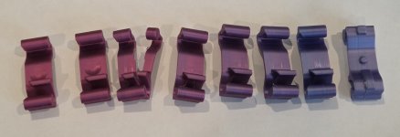

Got it on the first try! About 20 minutes to model and 15 minutes to print in PLA, including calibration
McMaster doesn't have the rivet size I need, so this is modeled with a larger one. I'll remake these in nylon once I order a roll and get the rivets on hand.

OK, I fibbed. Yes, the first one clicked in and probably would have worked, but why not make it better?
I forgot about a couple tabs on the bottom that register in slots cut into the rail, so I added them and thought that maybe I could skip the rivet and just model in a stud. I'm curious if these will stay put well enough to not need the rivets. It clicks in nicely and doesn't wiggle
One more running right now and then I think I am ready to print a bunch off and test in place.

Maybe leave the stud a little long and just add a drop of red locktite?
I'll have to see how it going in use. I'm inclined to think it won't need anything more as the round parts lock it in pretty well and my usage won't be harsh.
I could also make the stud extra long and use heat to mushroom the end, like a rivet...

@Zrexxer the guides fit great... We'll see how they hold up
Ended up needing 6
One slide is not working, so I left the 10" bottom right drawer with 3, which will work fine for my needs.
A few drawers in the left bank plus the top two were working well enough that i cleaned and lubed them in place. I'm using superlube for everything.
