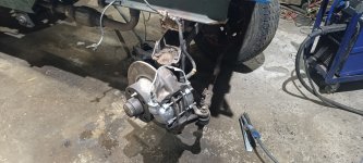

I started making brakes for my tractor. The main brakes will be hydraulic front, disc brakes. Maybe later I'll add separate brakes on the rear wheels. The operation of the tractor will show this. So far, I have made a bracket for the brake pedal and the main brake cylinder. Temporarily fixed it in the intended places. After the final adjustment and fitting, I will make a thorough fastening.

I installed the front brakes on the tractor to continue testing. There is only one brake so far, on the front right wheel. A longer test run showed that it is necessary to make a wheel turn limiter. Lowering the speed and thrust is more than enough. The video shows that I drove into the garage in first gear without touching the gas pedal. Moreover, an increase in engine speed in low gear does not affect the speed. Overall, it's not bad so far.

Vlad, great work on the tractor. Just a couple thoughts, I'm sure you are familiar with tractors and know most small horsepower tractors do not have front brakes, so are they really needed. And also rear brakes are a split pedal married when needed. Some even use just a single caliper and disc on either a drive shaft or axle. So can you avoid work by using less brakes. I know you have a plan in mind!
Keep up the good work and stay well!

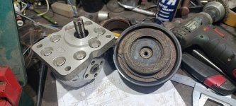

Vlad, glad you're here. Does the pump require a tank also for the hydraulics? Just thinking if you don't need a lot of litres per minute a power steering, belt driven pump might keep up.
Good Luck
I was thinking about using a power steering pump. I just managed to buy a couple of new gear oil pumps from hydraulic systems very cheaply. They are called NSh-10. I will use them, and I plan to use the fire extinguisher body as an oil tank.

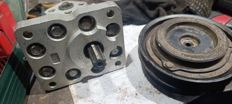

I continue to make hydraulics for the tractor, or rather, I invent a pump drive. I don't want the hydraulic pump to work all the time, so I make it unplugable. I have an electric coupling for turning on the air conditioner, I will use it. I have turned out several necessary parts on the lathe, and I will check it all together soon. When checking "on the table" everything works, it remains to check on the tractor.
IMG_20260413_203533.jpgIMG_20260413_203550.jpgIMG_20260419_191903.jpgIMG_20260419_191909.jpgIMG_20260419_191915.jpg

The hydraulic distributor and hydraulic cylinder that I will use on the tractor. First you need to put everything in its place, and then buy high-pressure hoses. It's not cheap either.
I had to redo the attachment of the swing assembly on the front beam. I first used a bearing assembly.
This turned out to be not a good idea, the node does not support lateral loads. When you turn the wheels, the front beam will turn slightly along with the bearing. Maybe it depends on the manufacturing quality of this node, of course. As a result, I removed these bearings and made everything primitively simple, an eyelet made of metal 10 mm thick and an axis with a diameter of 20 mm.
